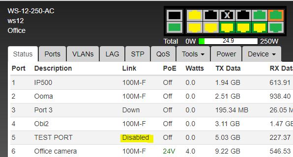

Disable
Code: Select all
ws12# configure
ws12(config)# interface port 5
ws12(port 5)# shutdown
ws12(port 5)# exit
ws12(config)# exit
% Applying configuration...
Press ENTER to confirm configuration change. If you do not hit enter within 60 seconds the switch will revert to the previous configuration.
port disabled in CLI

Thanks to jakematic now I get it Image
I did use the online help and IIRC, I did actually try 'shutdown' and 'no shutdown' but didn't realize that it wouldn't take immediate effect so it didn't seem to do anything.
