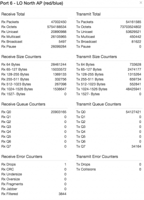

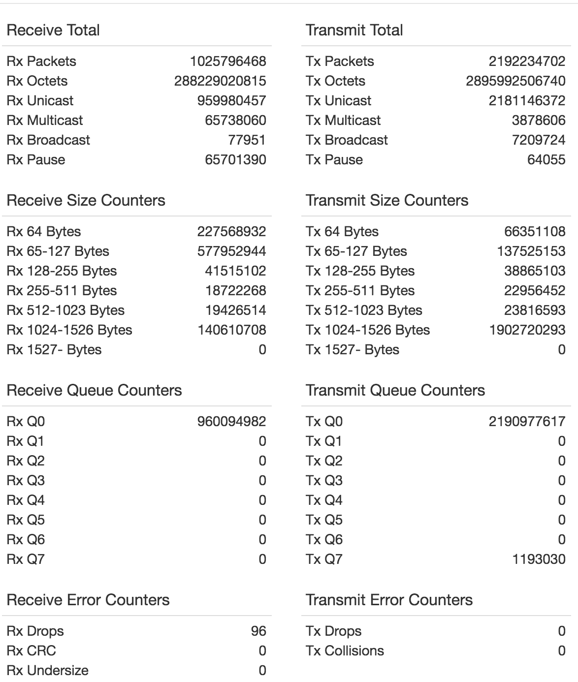

While trying to trouble shoot a different problem, I took a look at my port details on a couple switches, specifically those feeding ePMP APs (mix of 2000 and 1000's). I am seeing what looks like very excessive pause frames. This is fairly consistent across all of our switches on ports that feed our APs. None of our backhaul links have flow control on (either don't support it or they are AirFibers and we turn of FC).
Both of these are AP ports on different switches with many weeks of data collected:

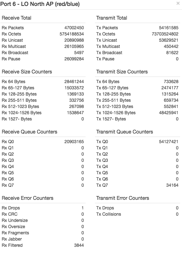

This portion of the network is flat but medium sized. However, as I did deeper into this, the switch ports with Cambium ePMP APs have huge pause numbers on the RX side - across the board. The ports with Mimosa A4 APs have very small pause numbers - some of them at 0 after weeks of use.
If I turn off flow control at the switch port on a ePMP AP and reset the counters for that port - the RX Pause Frames rocket right back up.

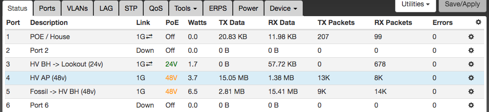

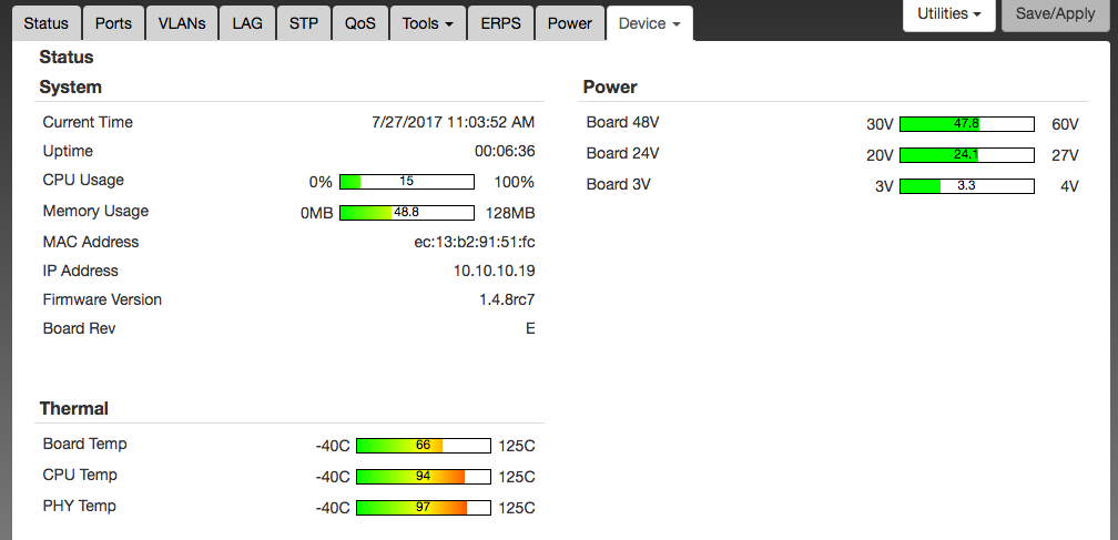

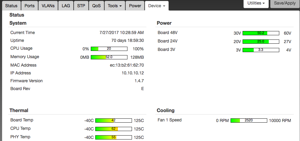

Please post up your Main Status Tab and Device/Status Tab

We are running 1.4.7 on production switches - we stay away from release candidates unless they fix something specific for us.

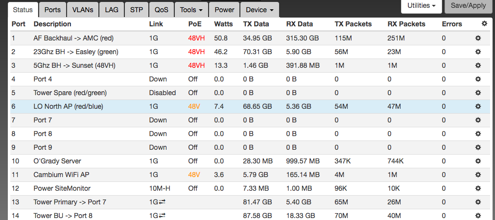

Here are screen shots from one of our switches. All of the switches connected to Cambium ePMP APs are acting the same (mix of 1000 and 2000 APs).
You can see Port 6 does not have flow control on. However, in the port detail page, you see tons of Rx Pause Frames. I reset the counters on this port last night. The other odd thing is the Rx Pause Frame # matches almost exactly the Rx Multicast number. When I reset the counters, I can watch both of those fields count up at exactly the same rate. And I see this on ALL of our ePMP devices. It does not matter if flow control is on or off for those ports. I do not see this behavior on the switch ports feeding Mimosa APs.

But beyond that not running v1.4.8rc7 on a DC switch is inviting a thermal shut down as it fixed a bad bug with the DC switches.

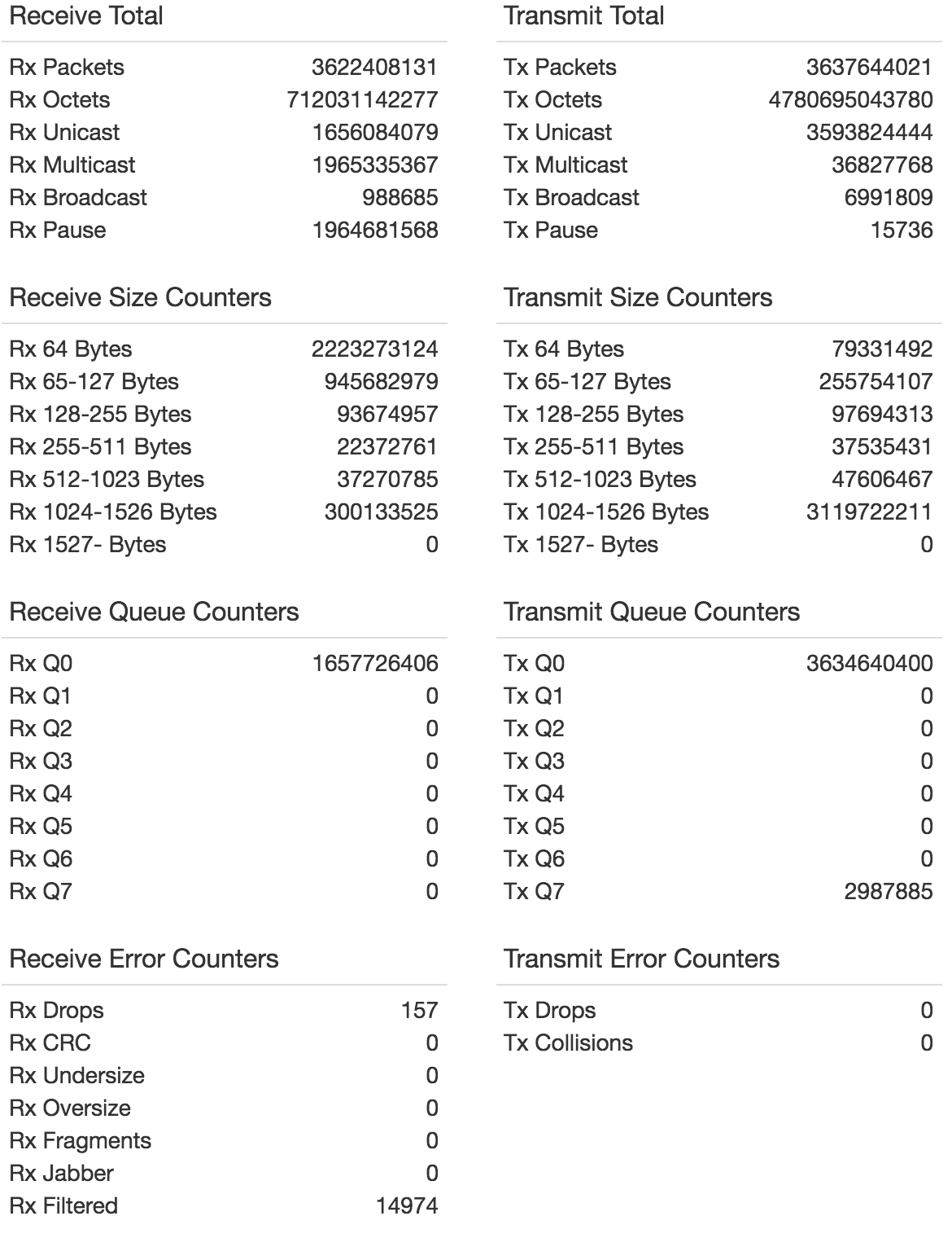

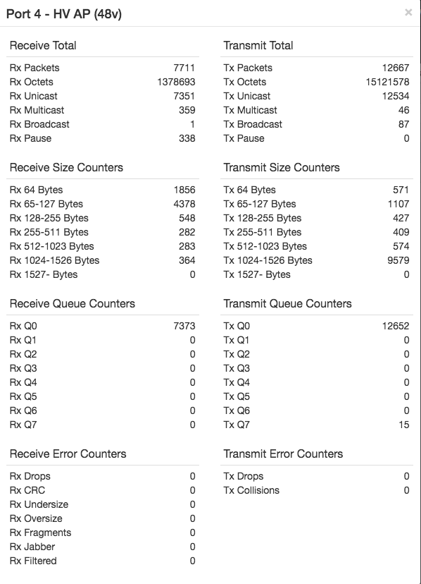

OK, took a different switch to 1.4.8rc7 (a WS-6-MINI). It has a ePMP 1000 AP on port 4. Reset all counters with flow control off (has been off). Here are the results. Same issue:

This could be that the device (radio) is not properly acknowledging that FC is turned OFF and is sending Pause Frames regardless.
If this occurs the switch would count them as we are seeing but ignore them.
Try turning FC off on the radio and see what happens.
I can confirm that FC is working as it should with other radios such as UBNT, when FC is turned off on the port the UBNT radio is not sending Pause Frames. (Even though UBNT still has a broken Flow Control on airMAX AC and AF radios where it sends a gazillion Pause Frames/Storm under some conditions).
My guess is your epmp radio is ignoring that FC is not negotiated and is sending them regardless and our switch is counting them but ignoring them.
