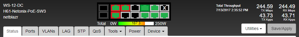

Here's the total bandwidth on a switch:
Switch
but here is what the manager displays for that switch:
Manager

Brough wrote:1. On the device display, Bandwidth displayed appears to be for port 1. I'd prefer to see the total bandwidth through the switch, or have what's displayed selectable.
I will ask Eric to chime in here. Yea it should be total bandwidth
