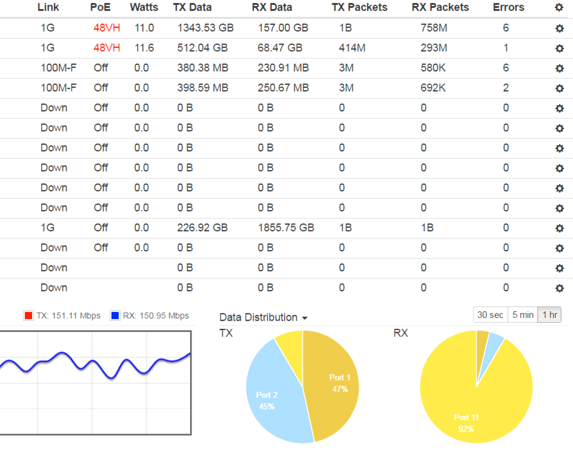

Curious how the data stats are being reported. Note the pie chart shows nice load balancing ... but data report is not balanced. The top two lines are the AF5X with LACP-A.
