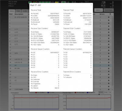

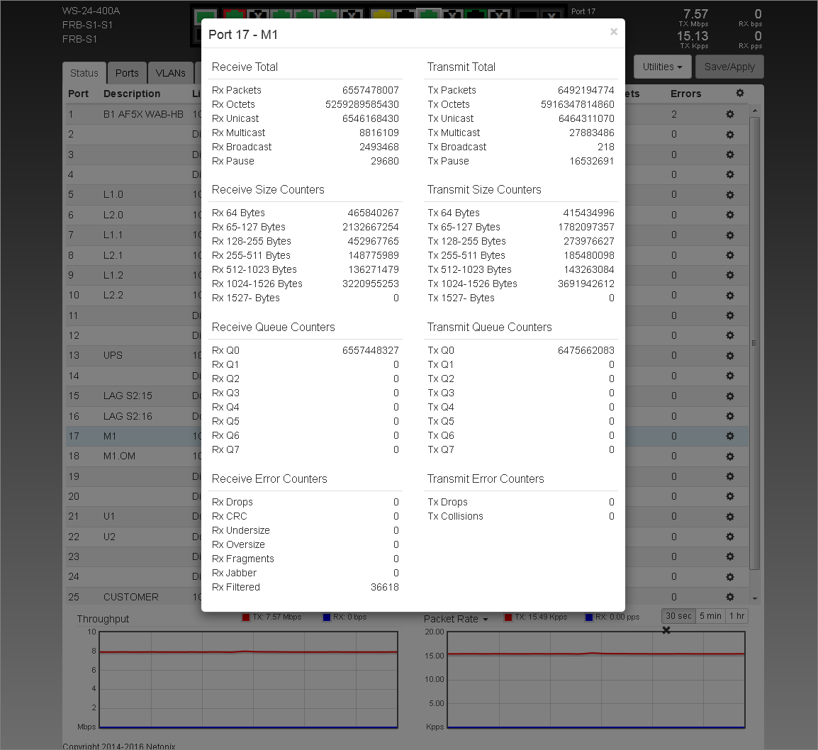

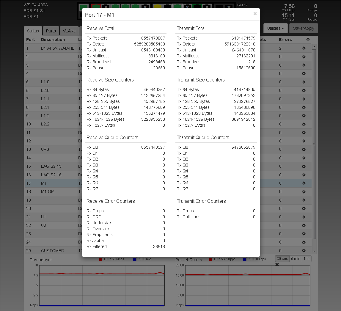

So I was hoping this had been fixed somewhere between versions and it would not come up again, but it did. It happened on a site with two backhauls, one being a Ceragon IP10 (on port 17, labelled M1) and the other being an AF5X (on port 1, labelled B1) ... so, aha, the AF5X again one would think, but not so:
All switch ports are set to FC=off on this switch except for the Ceragon IP10 port - I did it this way because the customer is critical and I didn't want to risk any FC issues. Only port 17 has FC=both because Ceragon IP10s have very small buffers and start dropping packets at 310 Mbps w/o FC, but can do the full 360 Mbps with FC.
So on a day with nice weather, the Ceragon link stopped working but the backup thru the AF5X saved our ass. This time I was able to take screenshots to document this. First note the graphs for port 17 (in the background) and see the switch sends 8 Mbps / 15 Kpps towards the Ceragon. Screenshot 2 was taken a few seconds (as fast as I was able to do) after screenshot 1:
Note that on the TX side, no Unicast or Broadcasts are sent - just Tx Pauses and Multicasts. The Ceragon didn't send a single byte towards the switch - it couldn't under this pressure of FC frames from the switch. When I set FC=off on port 17, everything went back to normal, and setting FC=both afterwards the storm would not start again.
The point is that the switch was causing this FC storm on its own. I want to emphasize again that all other ports have FC=off and they were working fine, or I would have lost access to the switch. Also, setting FC=off and FC=both on port 17 worked to restore normal operation for port 17 - I didn't do anything else because I kind of expected this to fix the problem.
The switch has firmware 1.4.7rc7. The FC storm breaker feature is enabled on the switch but it didn't do anything because it expects others to be the source of FC storms, not the switch itself.
