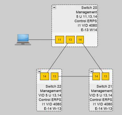

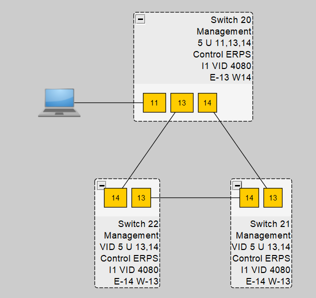

Re: v1.4.8rcX Bug reports and comments
Eric Stern wrote:The management VLAN should not be in the monitored VLANs. It could potentially be used for the Control VLAN, but my understanding is that most configurations used a separate dedicated VLAN for control.
On my config, management VLAN is 5 and control VLAN 4080. Those are separeted but control VLAN is not related to my problem.
All switch share a management VLAN to access those switch. How can I avoiding loop on management VLAN if I can't add the management VLAN to the ring ? Even with a management VLAN by switch (what would make no sense), I still have the same problem.
Here's a drawing so it will be easier to understand. As soon as VLAN 5 is part of the monitored VLAN list, I lost access via port 11 but switch can still be ping from one to a other so it's seem to affect every port outside of the ring.
You should not be able to add a MEP without specifying a port. I'll fix that.
Its my understanding that ERPS is used on customer VLANs, you would use STP on the management VLAN/port.
Ingnitenet Fusionswtich have a great documentation for ERPS.
https://ignitenet.uservoice.com/knowled ... er-manuals
At page 476, you can see limitation of ERPS. One of those limitation is:
Exclusive use of STP or ERPS on any port.
A other one is that control VLAN should not be management VLAN and should not have IP address. The CVLAN should also contain only ring port (so exclude of trunk). Ring can't be member of a trunk or LACP enabled port.
A other limitation is max 255 data VLAN but with QinQ support , that should not be a problem.
