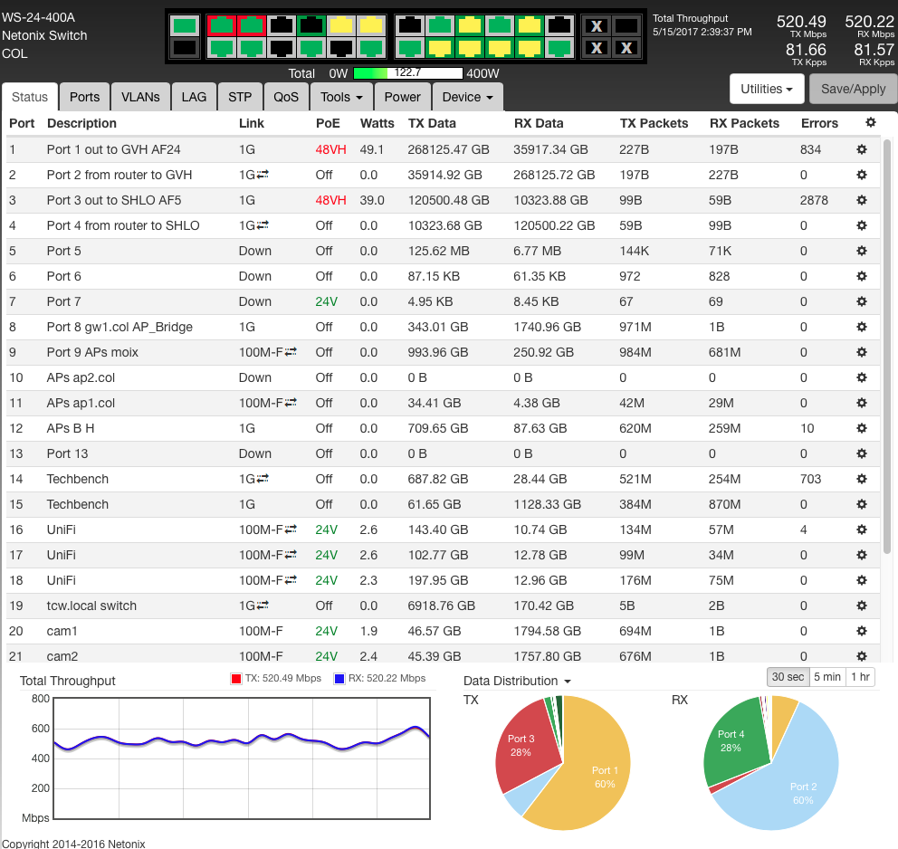

I will try the upgrade tonight during maintenance time. In the meantime, I'll build the WS-12-250-DC to take over in case of total failure.
We've had a lot of weather over the past month, but nothing since the 11 th. Doesn't mean damage didn't happen before then.

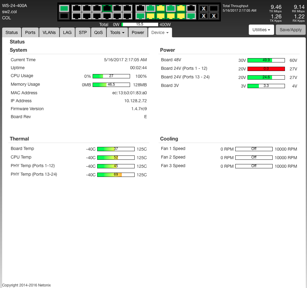

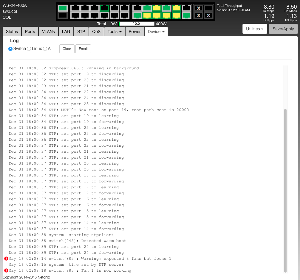

After moving important traffic off the WS-24:

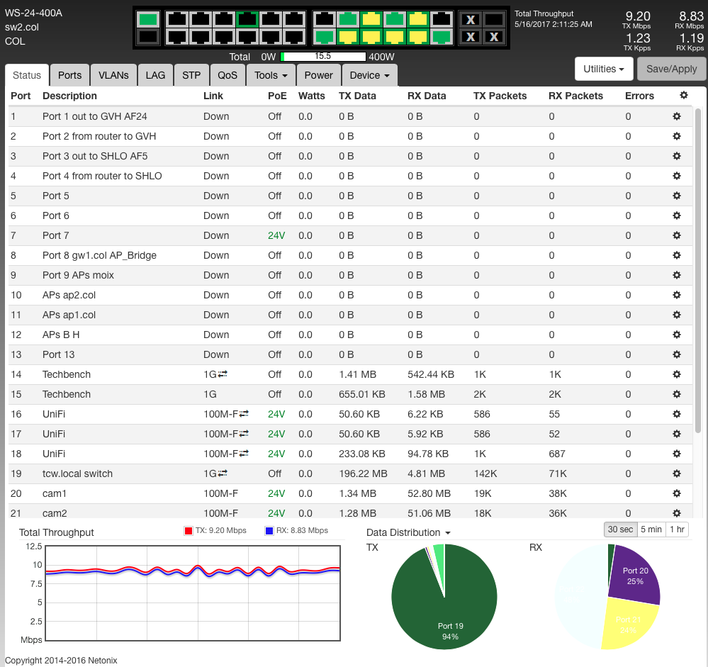

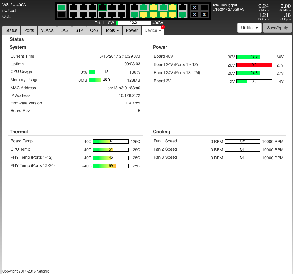

After tools -> reboot:

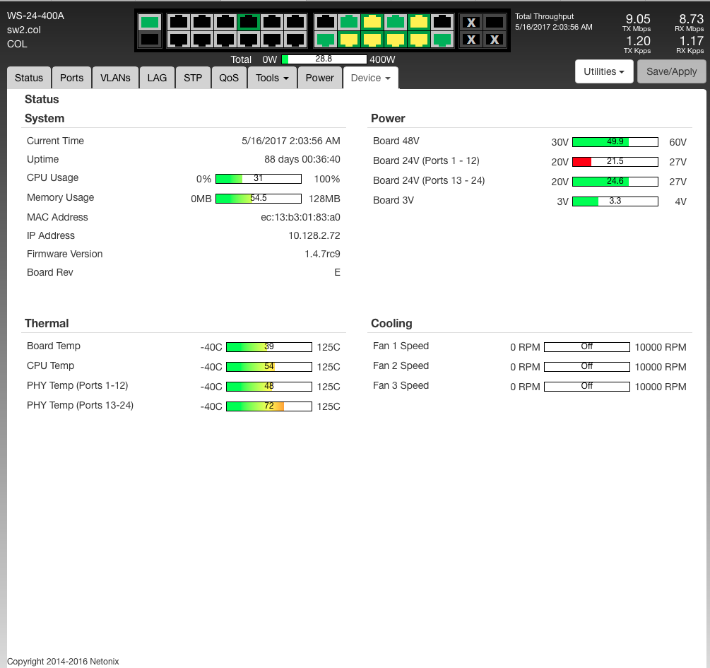

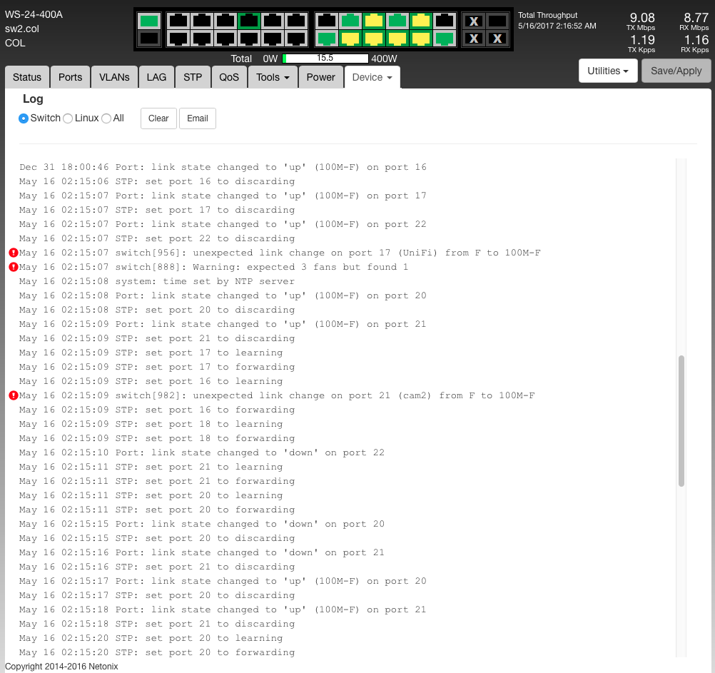

After pulling power cord for more than 60 seconds:

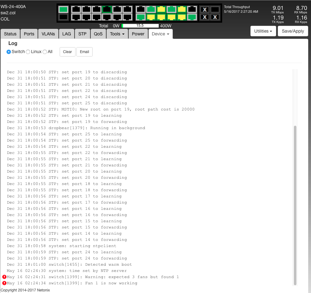

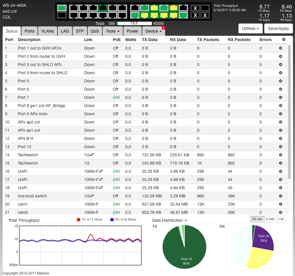

After firmware update to 1.4.7:
Re: WS-24-400A 24v rail low, no power to two devices of sev
Tue May 16, 2017 10:13 am
yea, you will need to RMA this unit.
It either has a failure or was damaged.
In case it is damage it is always good to review your grounding system.
