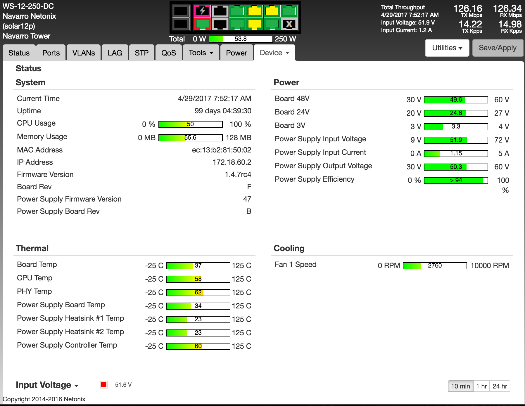

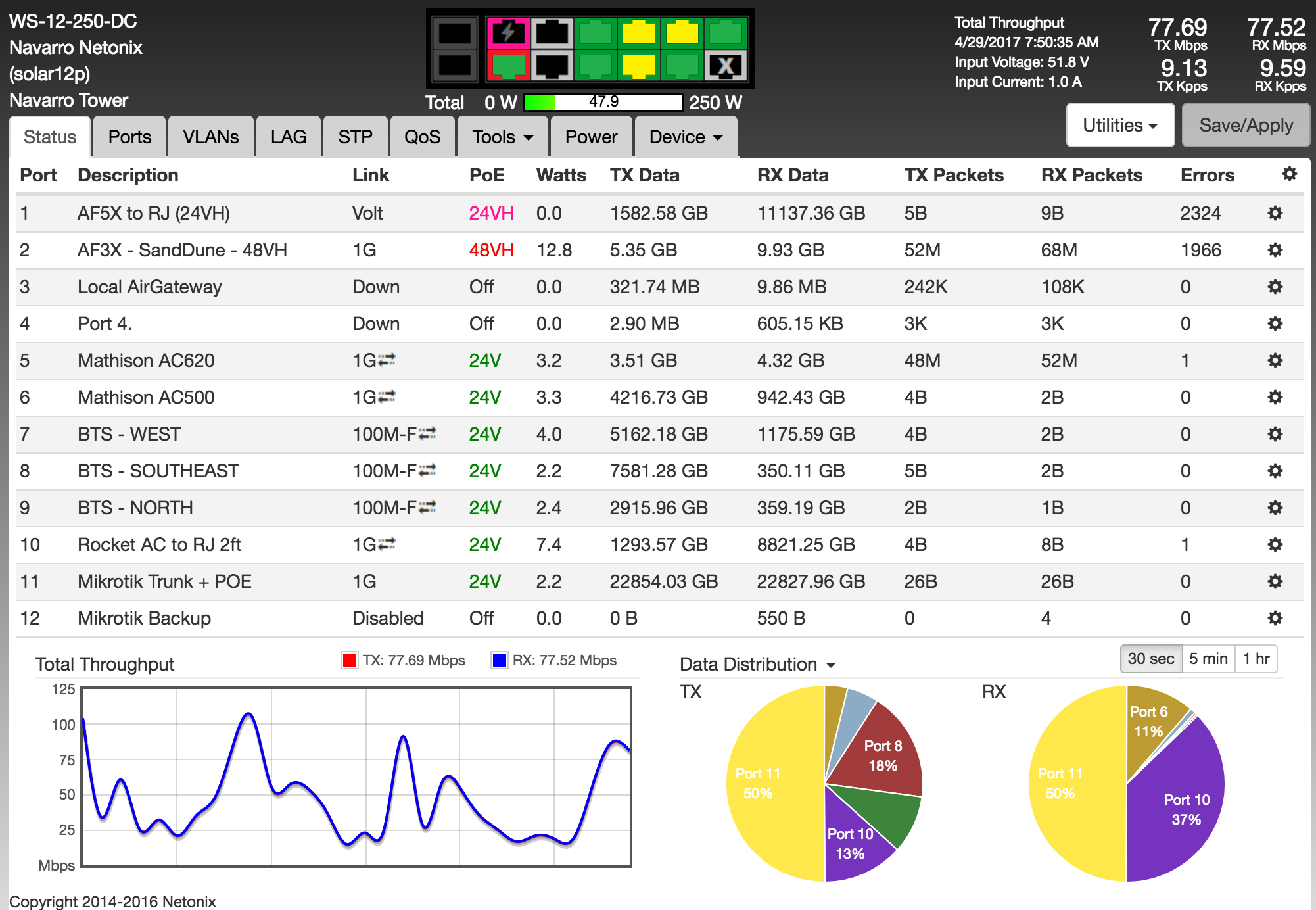

Post up the Status TAB and the Device/Status TAB please

Re: Netonix voltage issues or a Mikrotik hoax ?
Port 11 is the where the Tik gets powered. ~2.5W load.
Cable length is 1 feet.
Well from what your showing me I would say the MT reading is incorrect as Port 11 is only drawing 2.2 watts.
