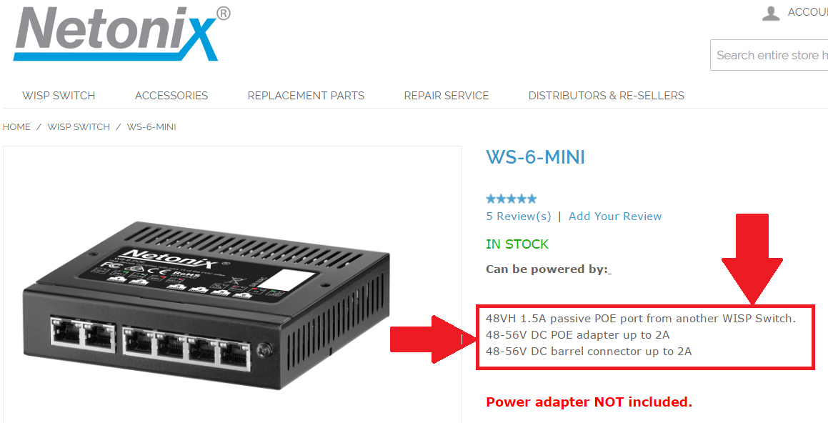

Your asking if you can power a WS-6-MINI via 24V????

You can not power the WS-6-MINI with 24V
I am confused why you thought you could power the WS-6-MINI with 24V ?
The switch "might" power up with 24V but it will not provide any POE.
