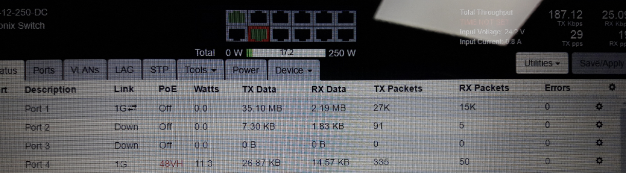

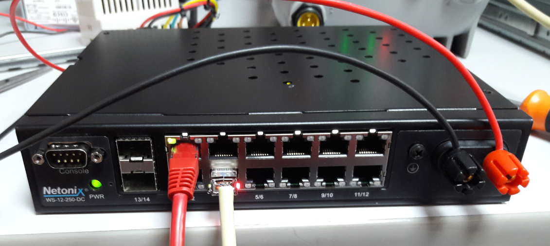

Hello all.
Good news for us, it is possible to power up a Cisco Aironet UPOE with our Netonix switches with 48VH but... some precautions needs to be taken.
DANGER, CISCO SHIT DESTRUCTION IF NOT DONE PROPERLY.
I lost one Cisco Aironet 1572EAC during the test, his sacrifice will be remembered forever Pirate4
The trick is to use a ethernet cross over cable to power the AP.
First i tried with a normal ethernet cable and 48VH in the switch, the Cisco Powered up but switch port did not link neither 1Gb or 100Mb or anything, if i force it to 100MF it linked up but no data was received.
Thsi Aironet acts as normally with the blinking lights and all ok but no link was stablished with the switch.
Later i decided to try with a crossover cable, i built it and tried another time, this time Cisco Aironet powered up and i had the link on the switch at 1 Gbps and i get some packets in RX side of the switch.
I do not have Wireless controller and i do not know if all is ok, but in appearance it is all ok now.
