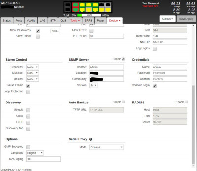

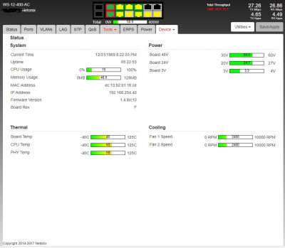

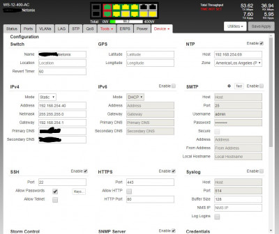

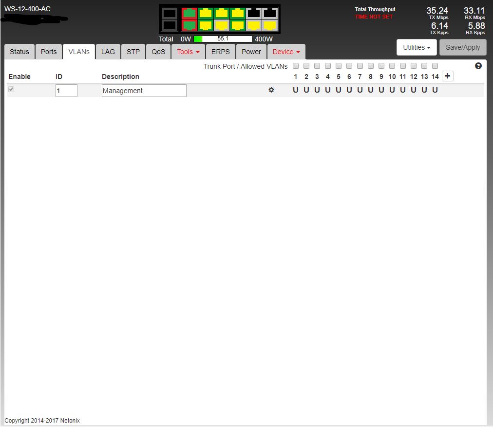

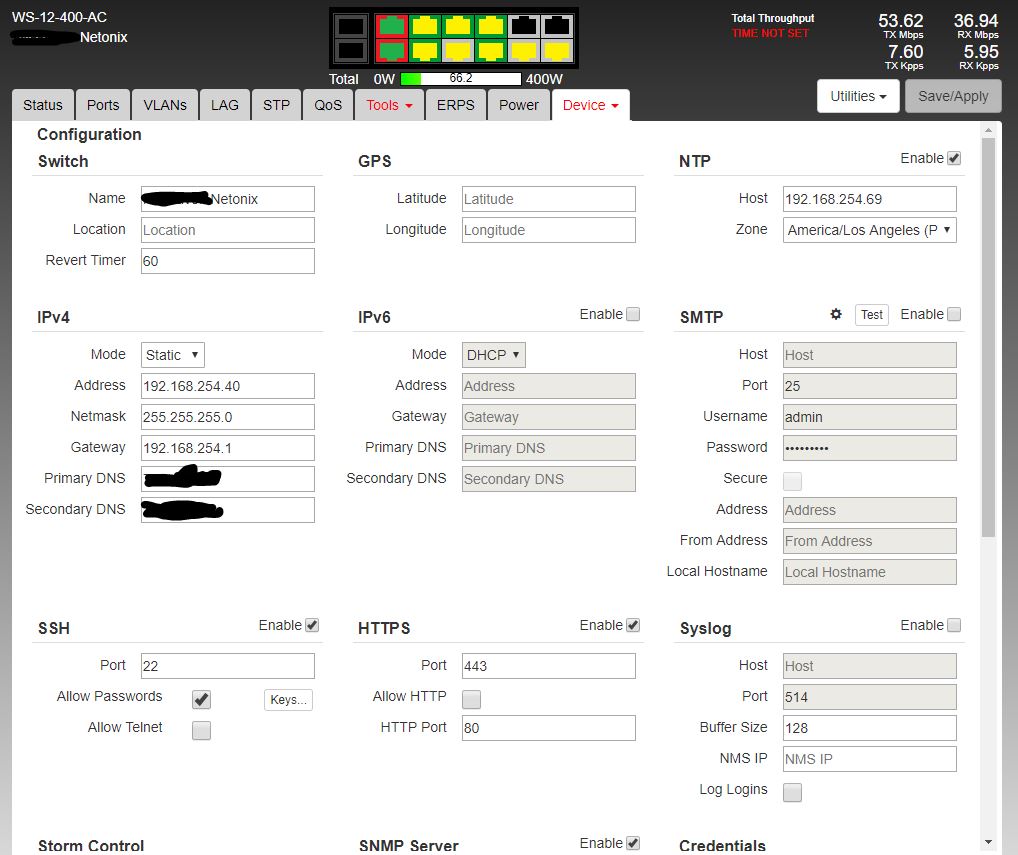

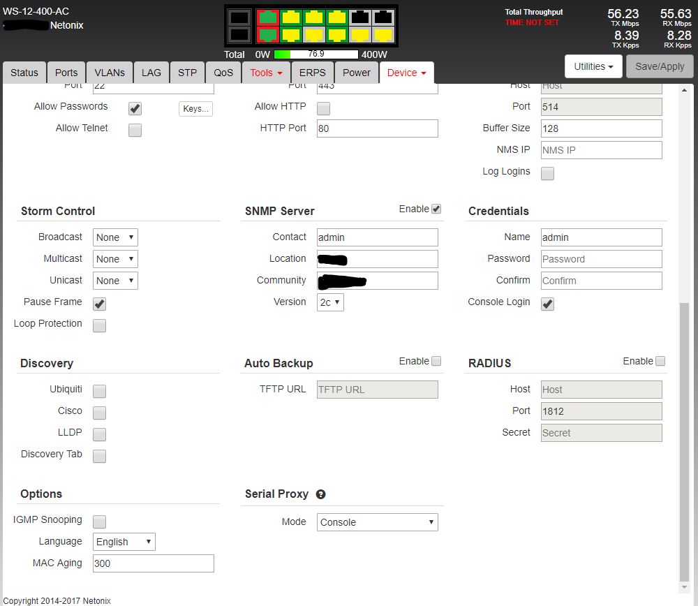

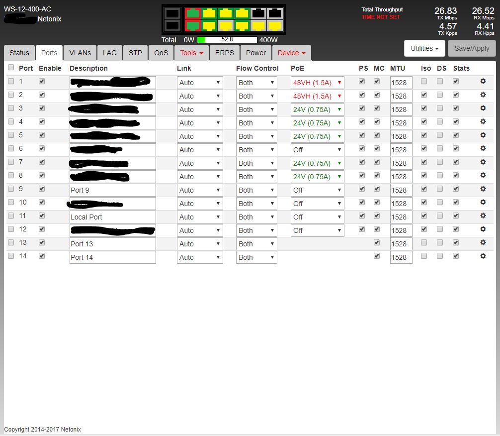

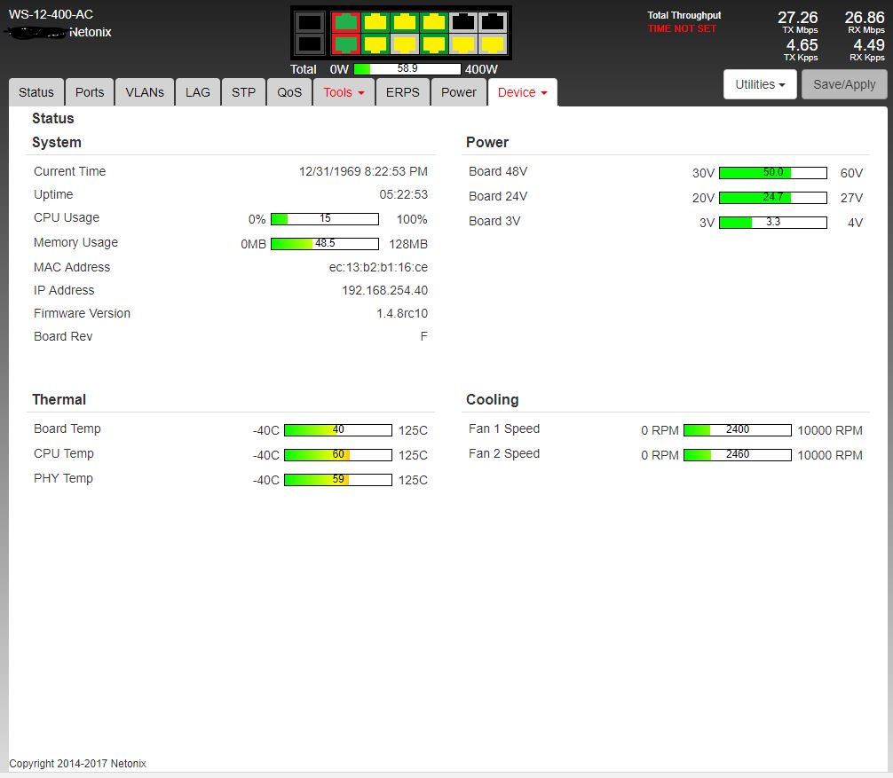

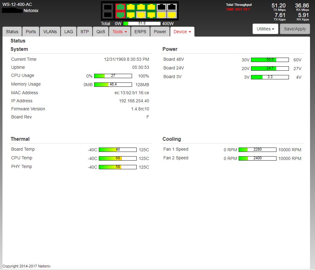

Re: Setting time and date
Please be using v1.4.8rc10
Please post up screen grabs of the following TABs:
Status
Ports
VLAN
Device/Configuration
Device/Status
Status
Ports
VLAN
Device/Status
- George Bradlink
- Posts: 17
- Joined: Thu Sep 07, 2017 6:35 pm
Hello:
We attached the screen shots and updated to v1.4.8rc10.
Thank you for your comments,
George
sirhc wrote:Please be using v1.4.8rc10 Please post up screen grabs of the following TABs: Status Ports VLAN Device/Configuration Device/Status
George
