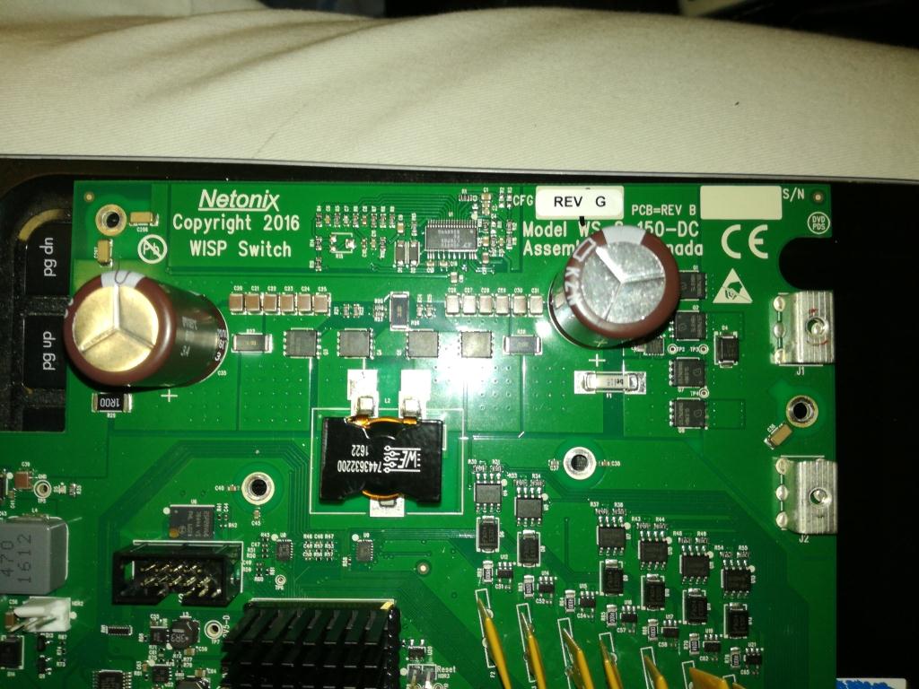

What if high Dc voltage was apply by mistake am in the same boat as well since am in Trinidad 84 volts was applied by mistake and i void the warranty by removing the sticker nothing seems burnt and would like to fix myself fuses seems good D1 diode seem OK any help would be nice, when power was apply there was a spark not from the system but connecting the power wires ImageImage[img]file:///C:/Temp/IMG_20171026_212314.jpg[/img]

I got the WS-8 150 DC REV G

Asuinetwork wrote:What if high Dc voltage was apply by mistake am in the same boat as well since am in Trinidad 84 volts was applied by mistake and i void the warranty by removing the sticker nothing seems burnt and would like to fix myself fuses seems good D1 diode seem OK any help would be nice, when power was apply there was a spark not from the system but connecting the power wires ImageImage[img]file:///C:/Temp/IMG_20171026_212314.jpg[/img]
Well the fact that you applied 84V voids the warranty so removing the sticker is insignificant.
When upload pictures follow the instructions in my post footers because we can not see pictures located on your local drive "C:/Temp/IMG_20171026_212314.jpg"
There is an Upload attachment link below the BLUE SUBMIT button for uploading pictures.
I am pretty sure the voltage regulator chip is fried as that is way beyond its upper limit but Julian or Dave can weigh in here.
Could we repair the power supply...."probably", "maybe", is it worth it though?
You can RMA the unit and send via postal mail.

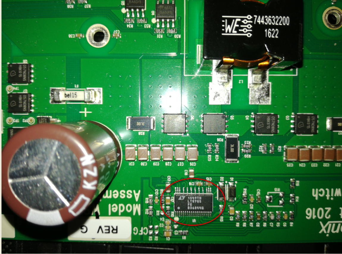

I would just replace the board can i order the board and how can i obtain it ?
is this what i need to test

all diode seems fine mosfet seems ok fuses are ok
