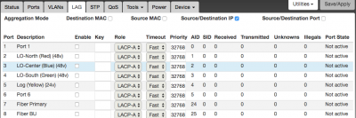

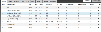

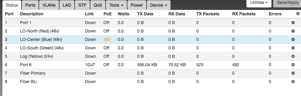

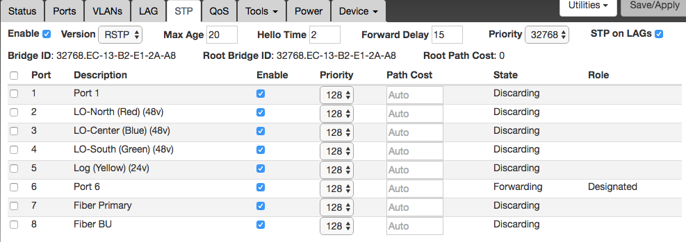

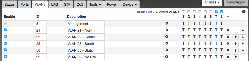

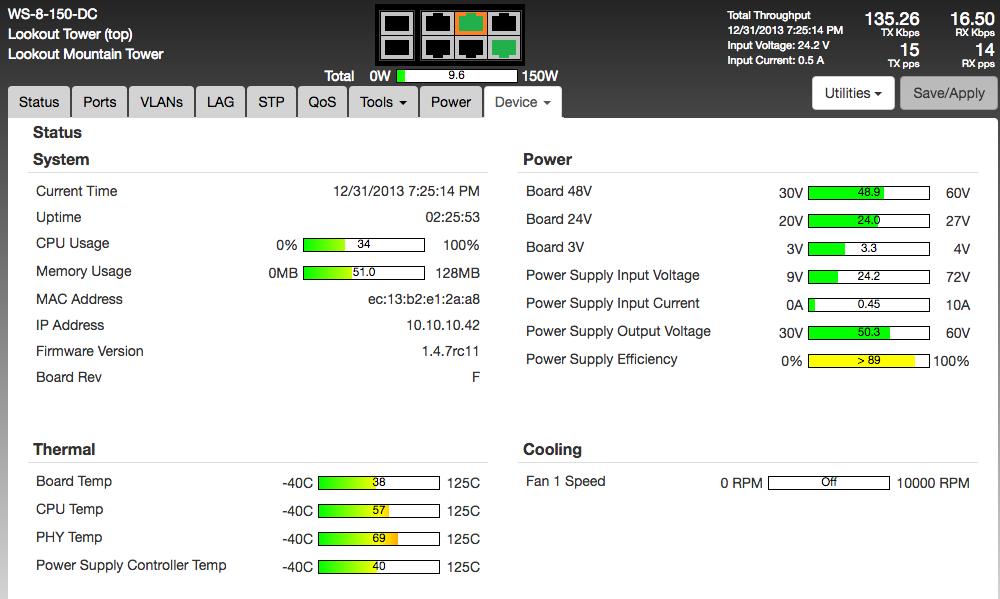

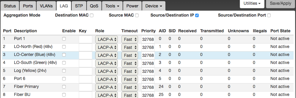

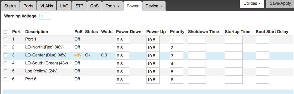

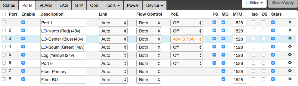

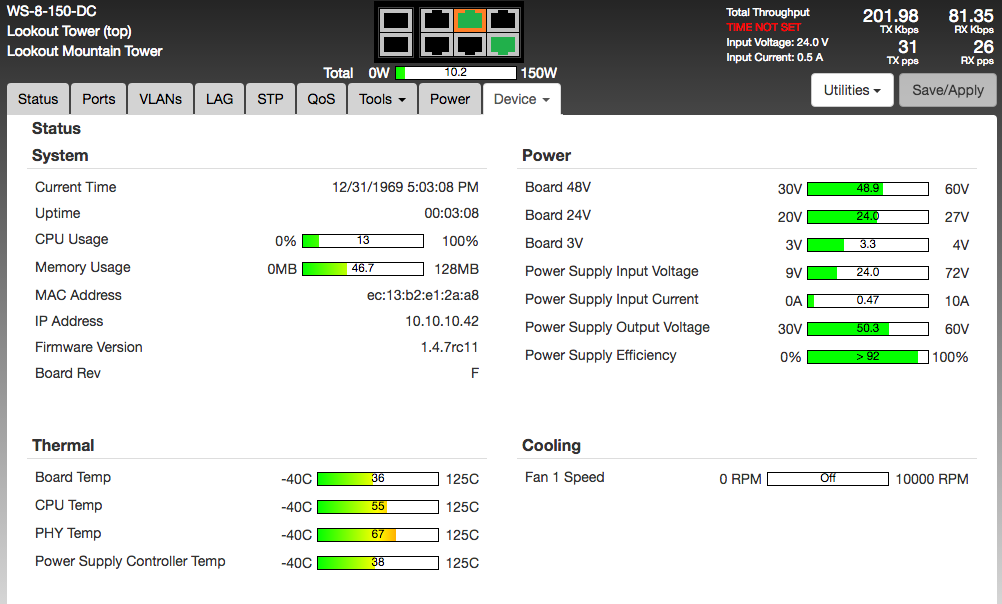

Here are screen shots of relevant tabs. The last Device -> Status shot is with the switch powering an ePMP AP on port 3 - the same scenario I had at the top of the tower. The only difference in the bench test is there is no fiber feeding the switch.
Here is the same Status -> Power with 100' of 12-2 gauge power cable in place on the bench - still powering one ePMP AP:

So you have the management VLAN with all 'T''s so when you brought it down off the tower you could not talk to it by simply plugging into the switch and access the UI as it would only respond to packets with VLAN ID 5.
I mean you could have gone into your laptop and setup a VLAN on the interface but if you had not done this then you could not log into it which makes sense that a factory default allowed to then see it.
I am not sure your issue was not a network configuration issue?

Myt laptop is set up for tagged VLAN5. That is how we communicate with all switches and radios on the network. Everything is tagged 5 on the mgt interface. So, I know the laptop is setup correctly. However, I did turn off VLAN5 tagging and tried to access it that way (as well as 192.168.1.20 untagged).
It was not a VLAN issue that prevented me from getting at it.
