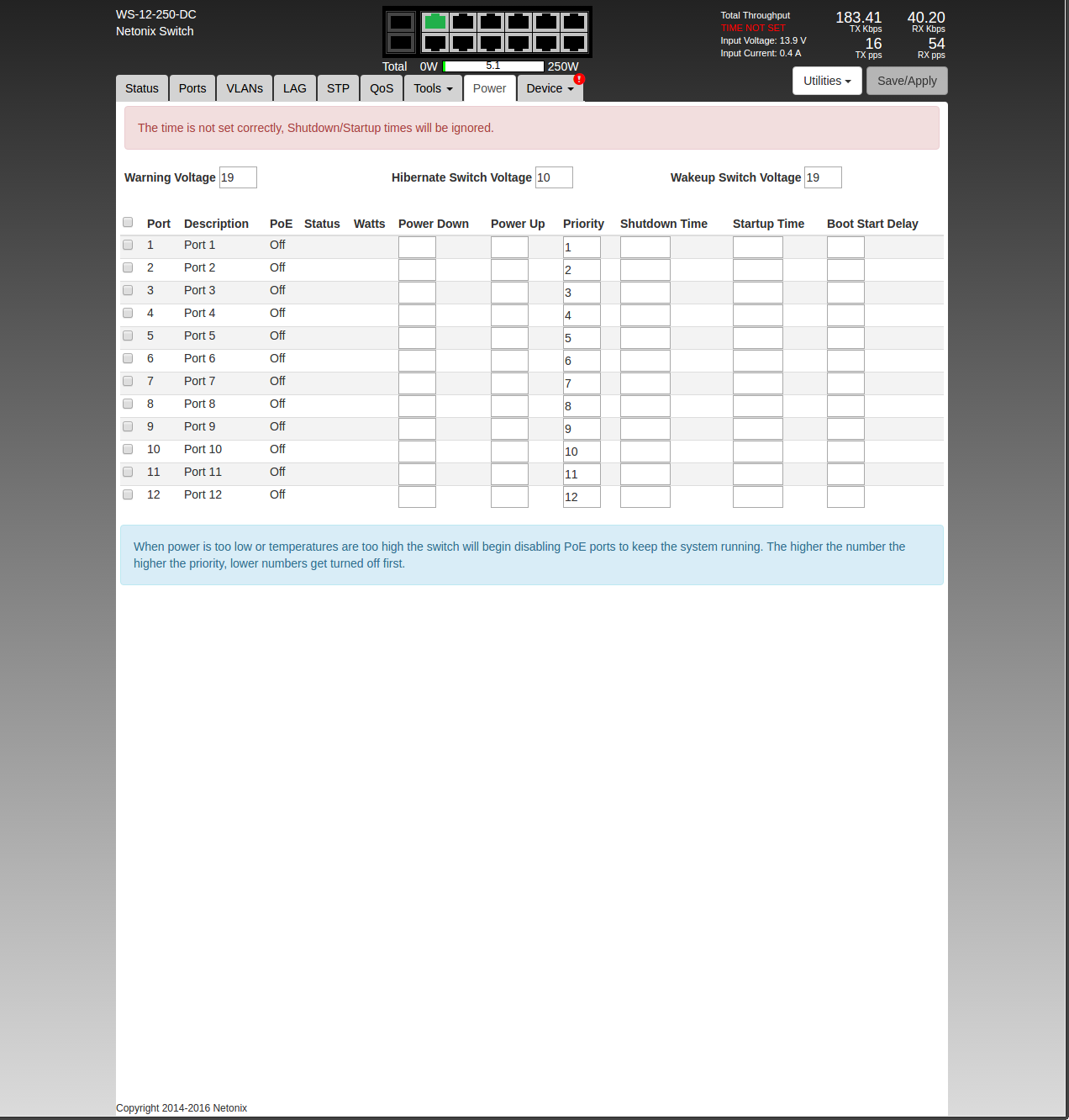

I modified the general wakeup voltage from the power tab to 19V. When I shut it down by lowering the voltage, then when I increase the voltage it sometime wakes up at 13 V like it used to before I changed the power setting. The behavior doesn't seem stable. Am I missing something ?

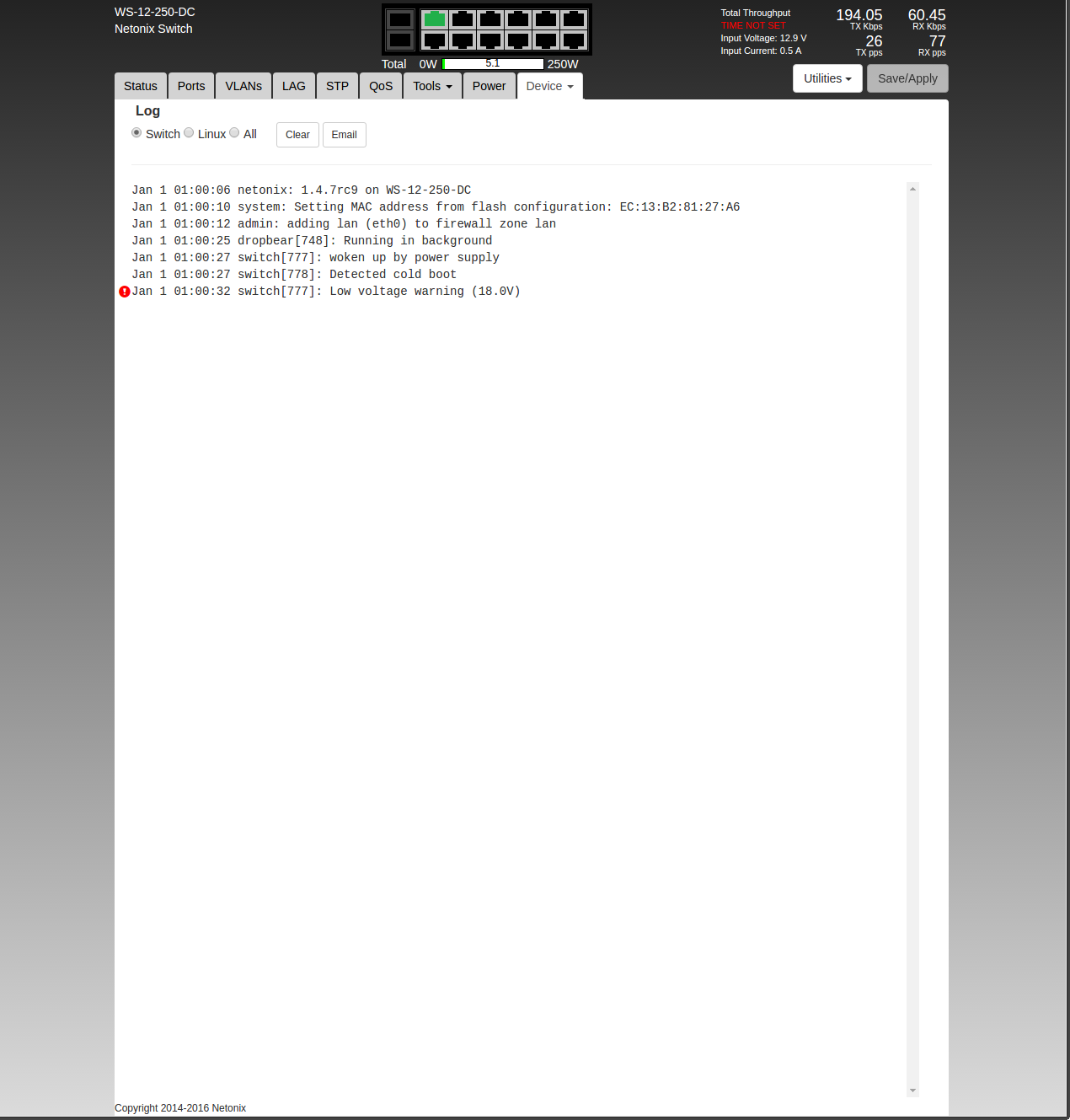

I attached some screenshots of the tabs of the netonix. (The warning in the log is due to the warning voltage)

Try changing the Warning Voltage to be 1V lower than the wakeup Voltage.
Right now you have:
Warning: 19V
Hibernate: 10V
Wake up: 19V
Try:
Warning: 18V
Hibernate: 10V
Wake up: 19V

Here is the log screenshot.
