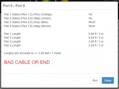

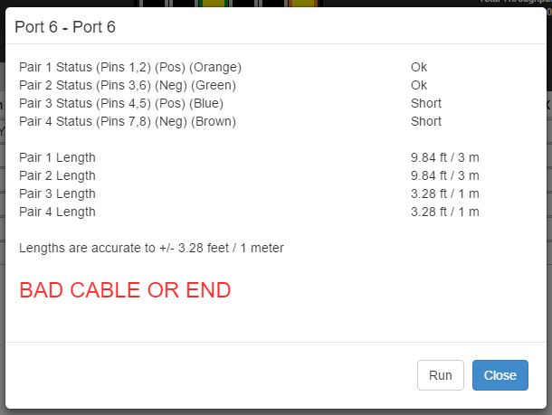

I have ran a cable test which has proved to be interesting, the results are below..
And when i first saw then i was concerned that i had bad cables... but we are getting the same port state change on every switch.. so i ran the cable test on every switch... and got the same result on every switch... I also ran it on some of the ports running the Nano's... got the same result every time i ran the test.
The pair length has to be incorrect as i installed all this kit and i know for a fact that the fly leads connecting the kit to the switch are 1mtr, in fact some are only 0.5. It also suggest that only two of the pairs within the same cable are different lengths... With this in mind I'm not sure the other results of bad cable and short status are correct either :cry:
Finally... regarding cables, taking into account every fly lead we use if factory produced, as we are getting the same error on every switch... on a single port in the main ( a little on others ) ... i can't believe its a cable problem

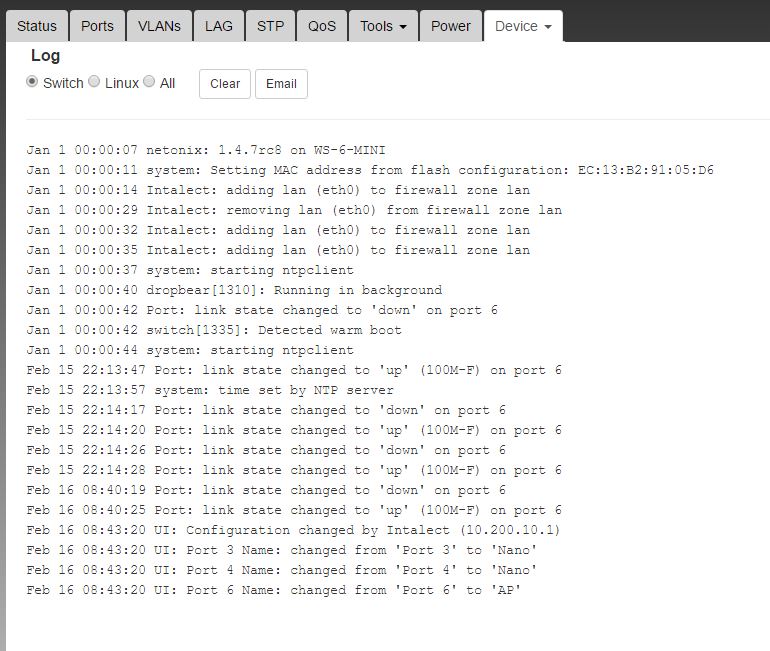

So moving on.. found something odd... looking at the logs on all switches this morning... all the switches that are slightly away from the main town area stopped reporting an issue around 8:30 pm ( GMT )... the two that are right in the town center stopped reporting issues around 9:30pm
Nothing has changed other that the one switch has had a firmware upgrade but that was later at around 10:30 pm from memory, so i am presume the logs stopped due to inactivity of client connections which is very likely as this location is not very busy, especially at night.

The cable diagnostics is NORMAL for UBNT airmax
Read this post: viewtopic.php?f=6&t=1178
Question: Why do I see short on pairs 3 and 4 on a of devices especially UBNT airMAX 10/100 gear.
Answer:
Because every manufacturer does not follow the proper design specs and use a 4 channel Ethernet Transformer designed for POE with a center tab for each pair. Since pair 3 and 4 is not needed to carry data with 10/100 only links they use them for power only which allows them to use a cheaper 2 channel transformer without a center tap for pairs 1 and 2. They then connect the 2 wires from each pair to the board skipping the need for a transformer with a center tap so the 2 wires from pair 3 are connected directly to the board shorted together for positive and the 2 wires from pair 4 are shorted together directly on the board for negative.

Having said all that... i have re-checked all the logs and unless they are not refreshing.. there are no reports listed.. well not many anyway and i'm totally cool with just a few.
This is the log so far for the same switch mentioned previously in this discussion

Re the issue with AirMax kit... does that also apply to Unifi... we are discussing in the main AP's here and not the Nano's
All UBNT 10/100 devices will show SHORT on pair 3 and 4, it is the way they made them.
It was not industry standard and should not occur which is why we say fail.
As far as the cable diagnostics showing incorrect length on the 1M or less cables the cable diagnostics is not that accurate with +/- 1M accuracy and when the device is not powered or the the pairs are wired directly into the board as they are with UBNT 10/100 devices on pair 3 and 4 this will mess with pair lengths on pairs 3 and 4.
