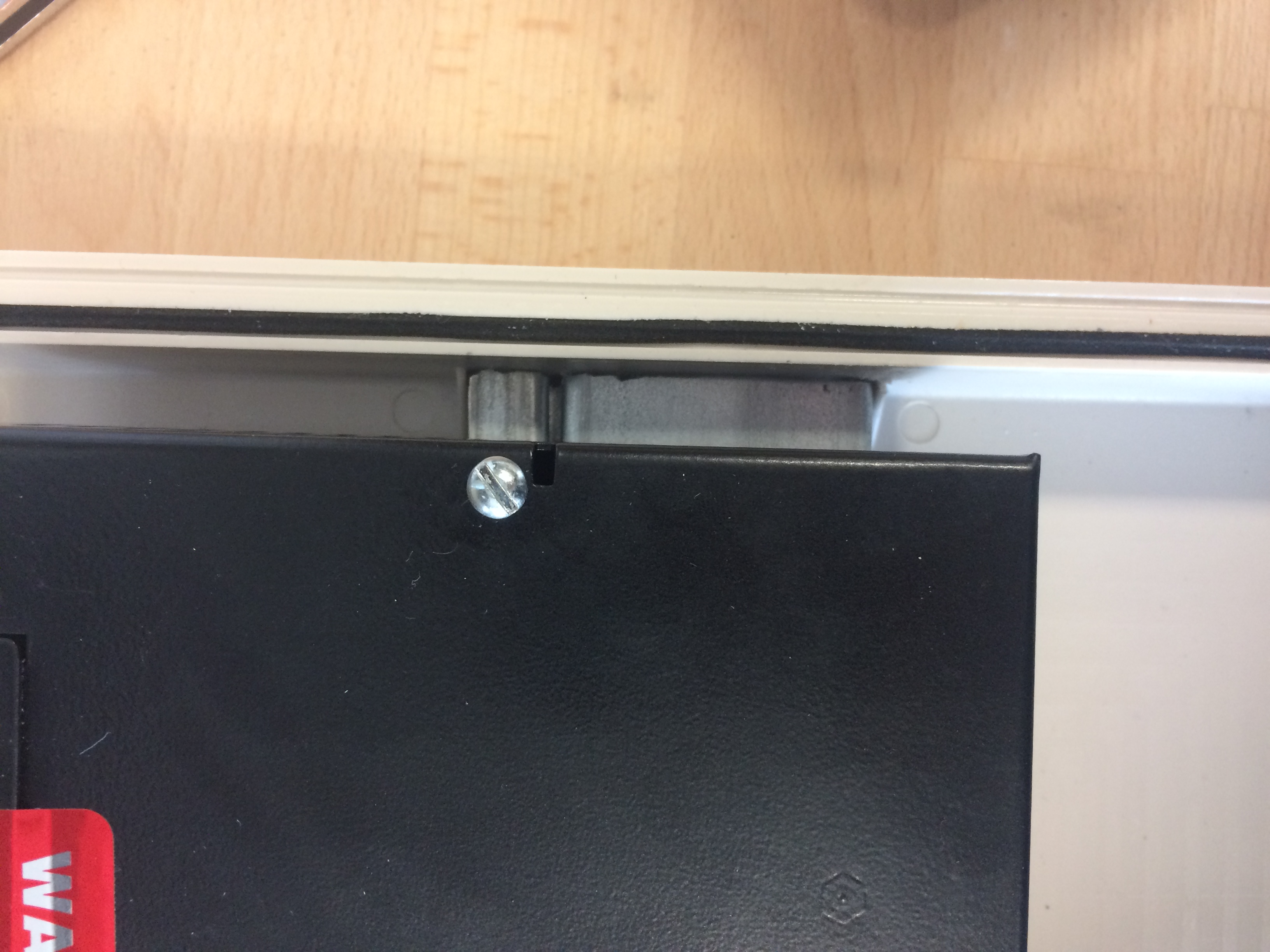

Not sure how it is supposed to work, short of screwing into the enclosure, but a piece of Ikea counter mounting rail fits perfectly between the strength webs in the enclosure.

Plastic isn't the best heat sink, and unless you cut the webs, the switch hits the webs before it sits on the back of the enclosure so there is an air gap. I figure a big chunk of steel makes a good heatsink. It would be interesting to set up two, one mounted the way Chris describes, and one mounted using Ikea rail, put them under the same load, and then graph temperature.
Just figured I'd post it in case other people happen t be looking for mounting options. I just happened to have spare ikea rail in my lab because I built out my lab using Ikea counters.

petecarlson wrote:Plastic isn't the best heat sink, and unless you cut the webs, the switch hits the webs before it sits on the back of the enclosure so there is an air gap...
Unless something changed, my MINI has air slots into which the webs fit so there was no air gap. I raised the same point with Chris about plastic not being the best conductor. It is still better than air...
Also, I cut the webs because I like the switch to sit lower down leaving more space at the top in case I want to access the reset button.

Yea, the "production" WS-6-MINI has slots for the webs so it sits flat against back wall. You got a pre-production model Les
Re: Mounting WS6-Mini in ENC-SW-8X5
Chris, I have both and while the slots are there, they force the switch to sit higher than I would like it to be. We had the discussion before about my wanting easy access to the reset button but you dismissed me saying that is not something that should be done up on a tower.
Anyway... I want what I want and I cut the webs to get what I want. Call me stubborn...
