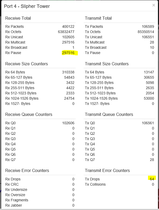

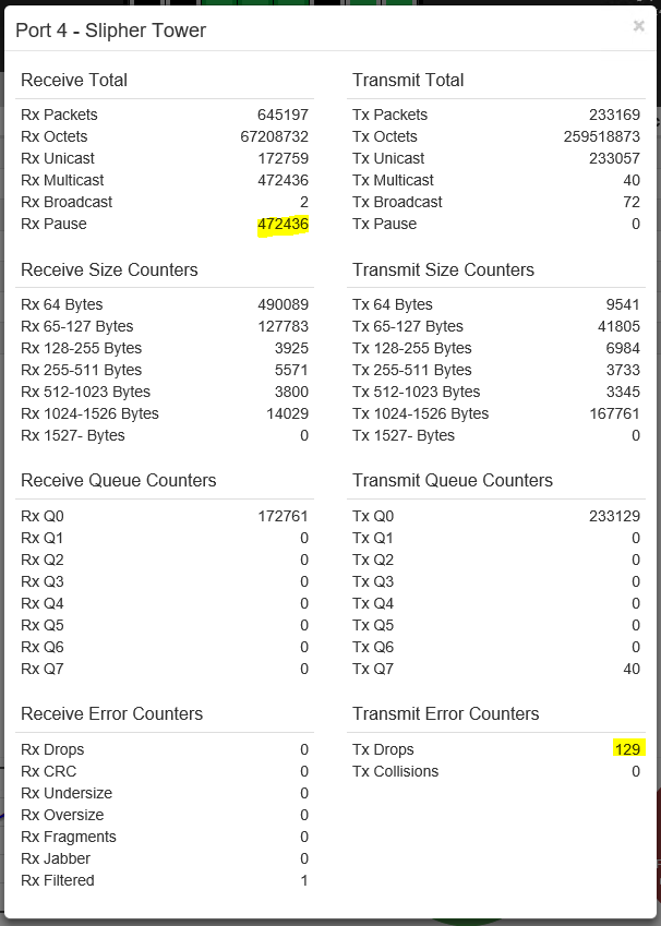

After further troubleshooting I believe the issue is caused by a Pause Frame storm that is killing traffic on the switch. Here is why.
I upgraded my Netonix switch to a FW that has their Pause Frame Storm protection mechanism and also upgraded all the Airfibers on this switch to 4.0b2. I then caused one of the wireless Airfiber slaves to break the link by changing the DNS server entry on the Network Page. It was either after the link went down or right after it came back up (sorry did not catch the exact timing), I lost momentary connection to all the other Airfibers on the switch and the data flow from the tower router stalled. It also caused the LACP LAG to reset.
Shortly after I got the following message from the Netonix Switch. Port 4 was the link that I caused to break but it recorded excessive pause in port 3? Switch stats in Port 3 did not show an abnormal number of pause frames.
Flow control was then disabled on Port 4 by the switches protection mechanism. I then reverted the DNS change on the Airfiber slave and the slave disconnected and the reconnected without any data interuptions to the LAG or the other AF on the switch.
I then renabled Flow control on port 4 and reset the port counters on the switch. It has ZERO pause frames. I then changed the DNS entry on the AF slave of the Master in Port 4 and either after the Slave disconnected or right after it reconnected the Pause frames shot up to 472000 in like 2 seconds and it also recorded an immediate 129 TX drops.
This was accompanied by these entries in the Netonix switch. Odd that it was ports 2 and 3 and not 4. Even odder that I have nothing even connected to port 2 and port 2 has all Zeros for its Port Details.
Was this issue not fixed by UBNT or am I misinterpreting and this is something else?

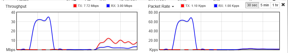

I did another test again on the link in port 4 and this time I watched the throuhput and PPS graph for that port on the Netonix. Again after breaking the wireless link by changing the DNS entry in the slave I got a data interuption for all the devices on the switch and saw a lower than before, but still much too high number of Pause frames sent by the AF5X in port 4 in the span of a few seconds.
Port 4 also recorded (while the AF wireless link to the slave was down) over 30Mbps of TX traffic and over 60Kpps all of which I expect were pause frames.
Big blue hump is while Slave was disconnected from Master.
So while I do get overall less pause frames on FW 4.x under normal operations, I now get excessive Pause Frames if the Slave goes offline by reboot, power loss, or setting change that breaks the wireless connection.

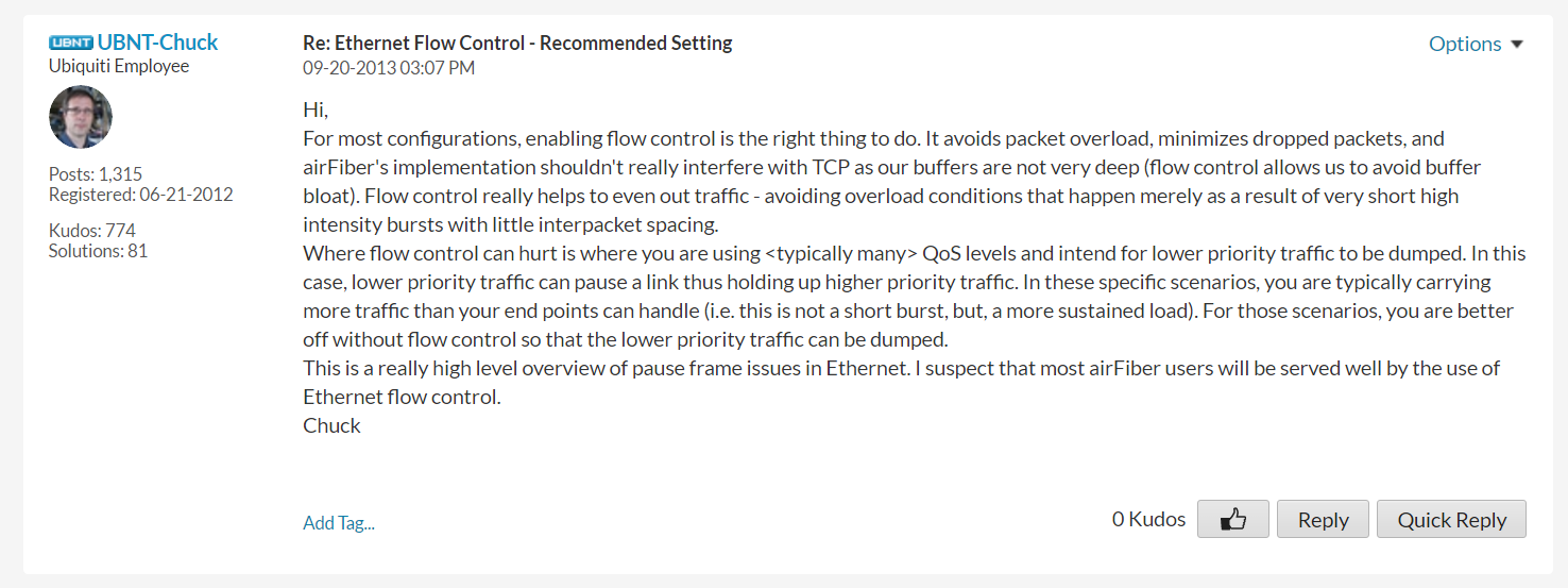

"Hi,
Let me start by saying that the use of Ethernet pause frames is problematic, period. I say this regardless of whose equipment you use. It is much better to allow overflow packets to be dropped and allow the layer 3 protocols to do their job of regulating capacity. The best advice I can offer is never to use it (whether you are using airFiber or not).
Having said that...
The current implementation of flow control in airFiber causes a full airFiber buffer to send Pause frames until the buffer condition clears. This design choice allows you to design a network where data overflows do not occur at the airFIber end of the link.
Ultimately, exceeding the link capacity must eventually lead to packet drops somewhere. You need to decide where this is. If you enable flow control across your entire layer 2 network, you are counting on this happening at the router. IF you choose this path (and I do not recommend this), you need to know that Ethernet flow control can and will disrupt your entire Layer 2 network. This is a fact of Ethernet pause frame life.
Having an option to disable pause frames after some period of time (modulating whether the feature sends pause frames or not based on how long we have been in an overflow situation) has merit and I will discuss this internally. Changes in this area, however, have a long lead time.
Chuck"

Funny thing is UBNT AF team used to tell people to use Flow Control?????
https://community.ubnt.com/t5/airFiber/ ... d-p/559729
Re: Ethernet Flow Control - Recommended Setting
09-20-2013 - 03:07 PM
Hi,
For most configurations, enabling flow control is the right thing to do. It avoids packet overload, minimizes dropped packets, and airFiber's implementation shouldn't really interfere with TCP as our buffers are not very deep (flow control allows us to avoid buffer bloat). Flow control really helps to even out traffic - avoiding overload conditions that happen merely as a result of very short high intensity bursts with little interpacket spacing.
Where flow control can hurt is where you are using <typically many> QoS levels and intend for lower priority traffic to be dumped. In this case, lower priority traffic can pause a link thus holding up higher priority traffic. In these specific scenarios, you are typically carrying more traffic than your end points can handle (i.e. this is not a short burst, but, a more sustained load). For those scenarios, you are better off without flow control so that the lower priority traffic can be dumped.
This is a really high level overview of pause frame issues in Ethernet. I suspect that most airFiber users will be served well by the use of Ethernet flow control.
Chuck
