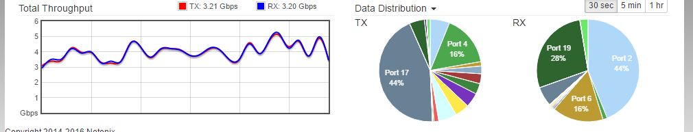

How would I figure out what is causing switch to show several gig throughput...start unplugging cables till it starts showing realistic numbers? Should be around 150 meg.
massive throughput

Well Sam the graph you are looking at is "TOTAL THROUGHPUT" for the whole switch which means traffic coming in one port and out another would be counted twice unless you deselect one port on the Ports Tab to not be included on the Total Throughput graph stats.
Maybe select each port one at a time on the Status Tab which will display what traffic is on that single port.
