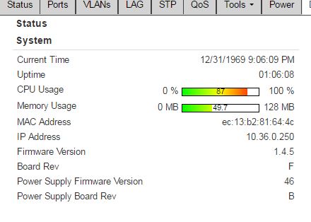

Getting high CPU usage on our DC switches.
Were all running 1.4.5RC2 so upgraded to 1.4.5 final but still seeing CPU at 90%+.

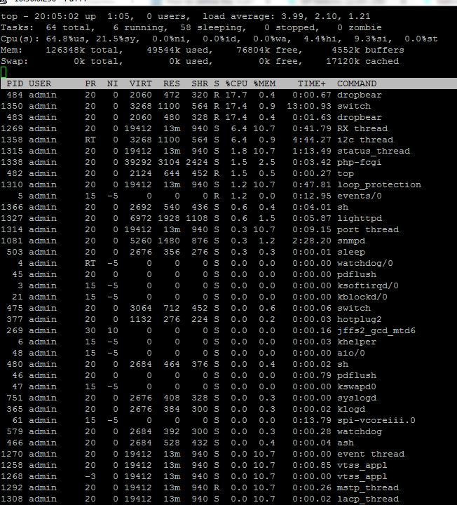

Running top gives multiple dropbear processes - ssh access is quite slow.
Only seems to be affecting our DC switches.
Have AC switches with similar configurations and CPU usage around 50-60%.
Any more info needed let me know.

On another switch I disabled one by one and monitored CPU usage.
Seems to be SSH causing the issue which I had suspected due to the multiple Dropbear daemons in top output.

As expected, no incorrect SSH logins logged to /var/log/messages.
This is not being caused by attempted logins by bots/other.
I've just noticed the SSH service is not running on the switches after being re-enabled.
I will have to schedule a reboot for later tonight to enable again.
I've set up a monitor through SNMP to report when CPU usage hits 85%+ so I'll know as soon as it does and can take a closer look at the switches.
Again, this is only happening on our DC switches.
All WS-12-250-DC, board REV F.
All our AC switches with similar configurations are not having this issue.
