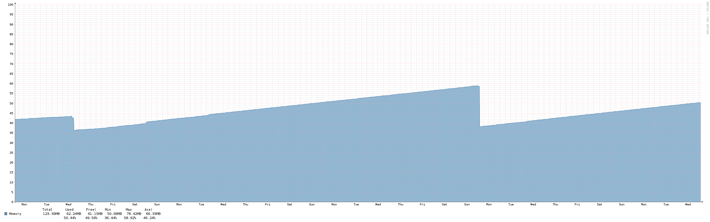

Are there still some memory leaks to be fixed?
I have 2 switches in production right now, WS-10-250AC (1.4.5rc7) and WS-8-150-AC (1.4.5rc4)
Memory usage is slowly rising all the time, but this was also happening on my WS-10-250AC when it was running 1.4.2.
All discovery services are disabled in the switches, the only thing enabled really is SNMP.

Could you take a screen shot of the Device/Status page 1 day then at a later day/time another screen shot showing the increase in memory as well as maybe do a TOP screen shot at Linux level on both events then post the screen shots as that would help?

Screenshots have been taken, I'll wait a while now and see.
In the meantime I have the graphs here from LibreNMS which is monitoring via SNMP.
The big drops in memory usage are due to me rebooting or upgrading the switches.
The first graph there is the WS-10-250-AC which was on 1.4.2 all the time until the drop which is when I upgraded to 1.4.5rc7.
And heres the config which is basically the same in both switches.

LOL, not the Device/Configuration Tab, the Device/Status Tab that shows memory usage and version. :ak:
