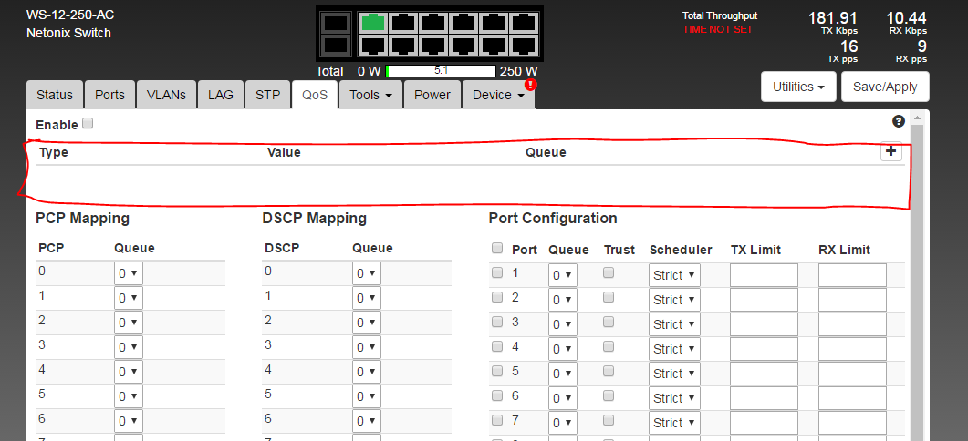

Are you shure that it was implemented in rc6 ? Seem like not. Testing it on a WS-12-250AC and it seem like it's the same QoS config from 1.4.4.

I miss it. Thanks Eric, I will look again tomorrow.
Also, could you explain why choose a queue by port ?
I don't see how it make sense since Vitesse chip has 8 queues per port.

I mostly copied the UI from another manufacturers switch, and they had that option. I suppose if you had a voip phone or something on a port you might want to give it higher priority than other ports.

So, if I understand well, it's the default queue so none matching paquets (paquets that don't match any rules like DSCP 48 = queue 6) will match this queue instead of the queue 0. Right ?

Yes.

Now, the problem I see is that you can set PCP and DSCP value at 2 places, in the PCP or DSCP mapping and in the rules. It's reflected in the config:
[*] "QoS_DSCP_Mapping": [
"DSCP": 10,
"Queue": "4"
"QoSRules": [
"Type": "DSCP",
"Value": "10",
"Queue": "6"
Personnally, I would remove the PCP and DSCP mapping and only leave rules.
Also, range for DSCP and port would be nice. Subnet for src IP could be a other interesting option.
Exemple:
DSCP 24,26 queue 5
DSCP 46,48-55 queue 6
etc.

I'll remove the mappings and add ranges for DSCP and PCP.
You already can optionally add a subnet to the src IP.
