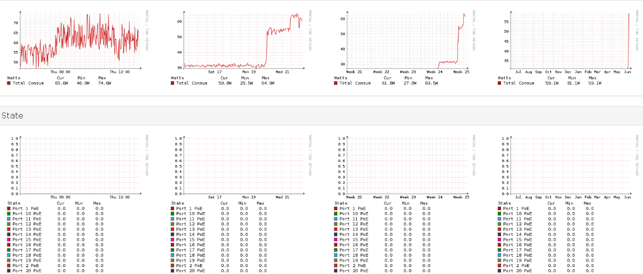

jjonsson
Posts: 337
Location: Denmark
Has thanked: 37 times
Been thanked: 65 times
Re: LibreNMS Netonix Support Updated
Tue May 23, 2017 5:42 pm
tonym
Posts: 31
Joined: Thu Nov 19, 2015 1:42 pm
Location: Havelock, IA
Been thanked: 7 times
Tue Jun 13, 2017 11:07 am
It is as described in the ticket. Netonix does not fully support Q-BRIDGE-MIB, they only implemented some of the required fields and some incorrectly.
They seem to have a habit of only partially implementing standard MIBs. They are aware of the issue and hopefully get it it fixed next release.
scracha
Posts: 53
Joined: Thu Sep 15, 2016 8:36 pm
Has thanked: 5 times
Been thanked: 5 times
Thu Jun 22, 2017 12:02 am
Overall consumption is useful but is it possible for LibreNMS to obtain individual wattage / consumption per POE port? With solar sites it'd be really good to have stats on what a radio uses over a 24 hour period etc.
