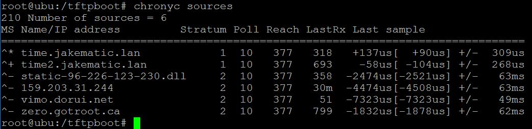

Why not run your own?
I've had a pair of these for about 5 years now: https://www.css-timemachines.com/produc ... e-servers/
There is an OCXO version if you need higher precision, and they don't cost a mint.
They make some awesome POE clocks too...
