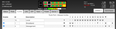

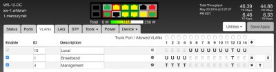

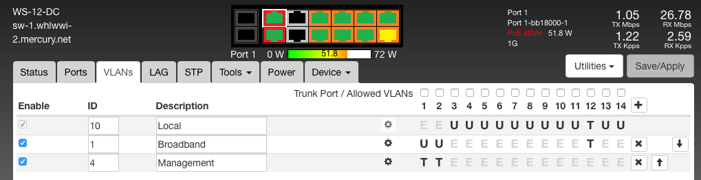

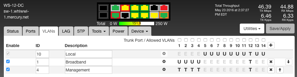

Re: Spanning Tree Questions
Can you also post up screen grabs of the VLAN and RSTP and Device/Configuration Tabs I am sure he will want to see them.
david.sovereen@mercury.net wrote:How do I upload the images?
Right below the BLUE SUBMIT button there is an "Upload Attachment" link
You can upload all you need

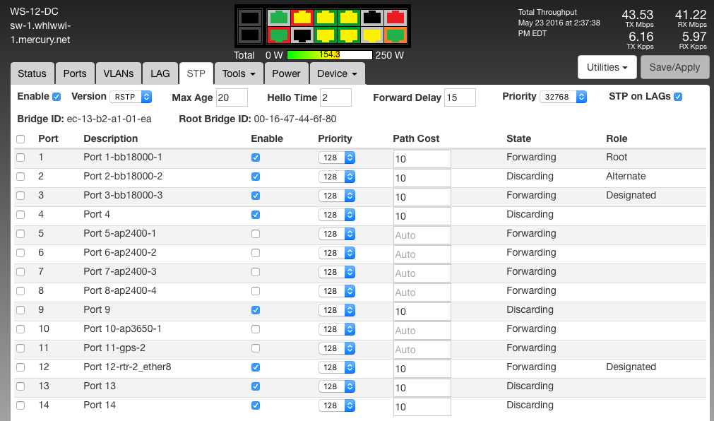

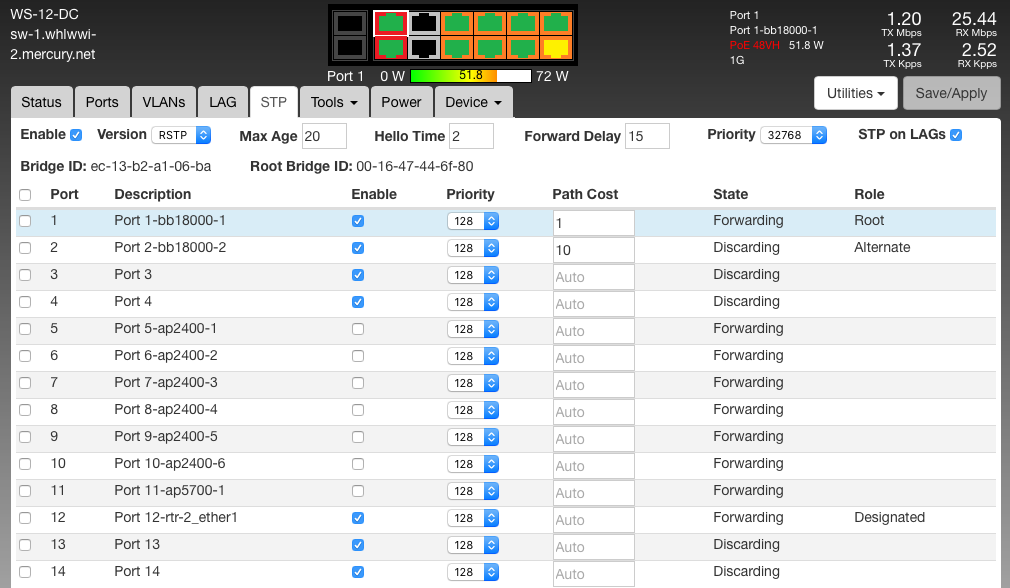

This switch sits between a Cisco switch off Port 1 and a Mikrotik off Port 2 speaking RSTP.
Port 2 is in Discarding mode and it should not be. It doesn't seem to be processing RSTP packets from the Cisco and Mikrotiks. Port 2 and Port 3 should be Forwarding/Designated if it were processing RSTP correctly. When I packet sniff on the Mikrotik off Port 2 of the above Netonix switch, I see BPDUs from the Cisco and no BPDUs from the Netonix.
This switch hangs off the above switch on Port 3.
I have to manually set the Path Cost on Port 1 to 1 in order for it to want choose Port 1 as the port to root. Really, Port 1 should be Forwarding/Root and Port 2 should be Forwarding/Designated if it were processing RSTP correctly.
