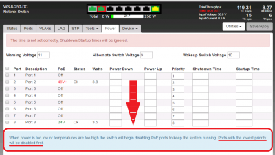

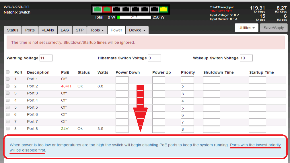

I argued to have Priority the other way around but come on guys it is right there on the screen? :headb:
The only way I can think of to make it more clear would be to hire little people to hide in the boxes and pop out and read it to you. :crazy:
Yes a manual would be nice but if most people refuse to even read what is on the UI right in front of you how many people would read the manual? We have opted to spend more time to lay out the interface as simple as possible and provide Balloons, Pop-Ups and in this case a BIG sign explaining the value.
