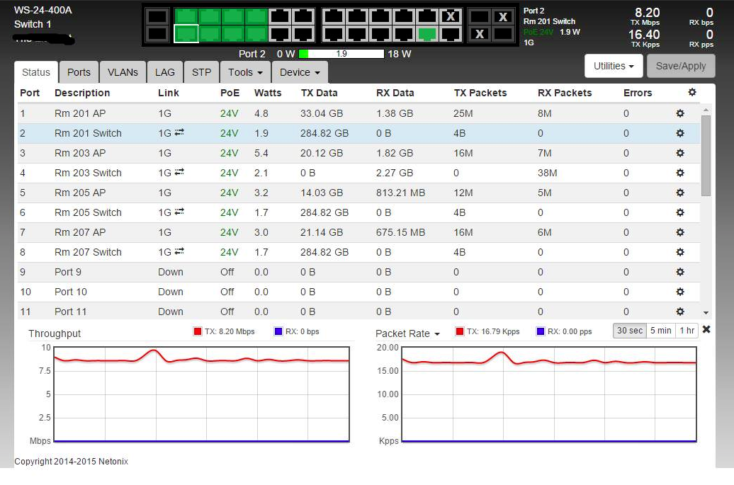

Please post up a screencap of your Main Status Tab Adair.
