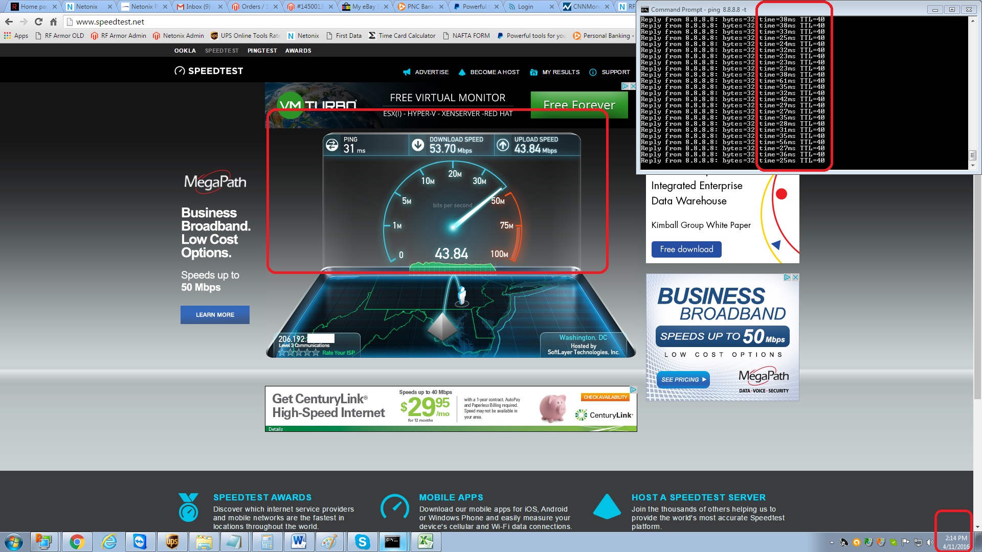

This is a video of a tower yet un stuffed. Today it has (2) AF24 back hauls and some (12) 5GHz sectors.
https://www.youtube.com/watch?v=2DgFoDwmPSc
Once again I am at RF Armor 3 miles to 20 MHz sector 20+/- subs (hitting the tower in that video)
