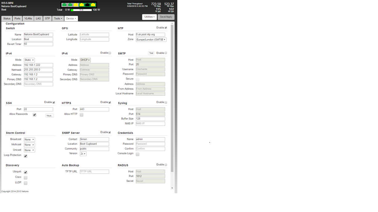

Please post up screen grabs of your config Tabs.

Real noob question - how do I post an image? (other than pointing to a URl)

simon1 wrote:Real noob question - how do I post an image? (other than pointing to a URl)
Teamview upgrading to V11 free version...
Scroll down below input box where you are typing your message and click upload attachment then browse to file, then place cursor in edit box where you want picture then click insert

laptop plugged in shows 1G as per screenshot, but *no* connection through that link. Had to enable wireles to grab the screenshot from device web page
