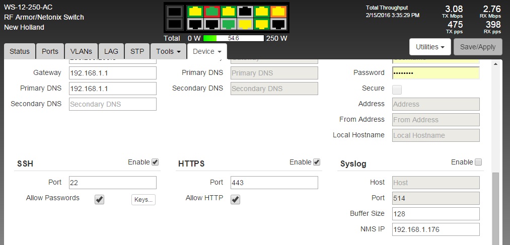

Bonjour
Je relance ma demande a NETONIX . si possible de créer dans l'interface réseau un port web pour piloter à distance mes netonix ca serai vraiment super !! :thumbsup:
Merci
Re: Port web
Mon Feb 15, 2016 4:37 pm
Please try and describe what you want a little better.
You can change the HTTPS port already
You can enable HTTP but you can not change the port HTTP uses as it currently only uses the default port 80

Bonjour
en faite mon port 80 est déjà utilisé sur mon réseau
je voudrais mettre un port web exemple 2280 sur mon interface netonix pour avoir à distance
exemple: 82.125.56.32:2280
mais ça ne fonctionne pas ...

Re: Port web
Fri Feb 19, 2016 9:24 am
quadra wrote:bonjour
pas de solution a mon probleme ?? :Cry2:
Currently" the software does not support changing the HTTP port.
You can change the HTTPS port but not the HTTP port.
We can look into allowing the user to change the HTTP port in a future firmware version but for now there is no way to change the HTTP port, sorry.

Re: Port web
Fri Feb 19, 2016 10:09 am
Pourquoi pas simplement utilisé HTTPS ? Une limitation de navigateur ?
Re: Port web
Fri Feb 19, 2016 10:37 am
HTTP should not be used when traffic traverses the internet since it is not secure. Use HTTPS.

Re: Port web
Fri Feb 19, 2016 2:17 pm
Maybe he want to be able to change both http and https port and http still redirect to HTTPS. Exemple, you can do that with ubnt device, change http to 8080 and https to 8443 and http request to 8080 will redirect to https 8443 port.
Re: Port web
Fri Feb 19, 2016 2:31 pm
I have made a request to Eric to add this ability to the next firmware release.
