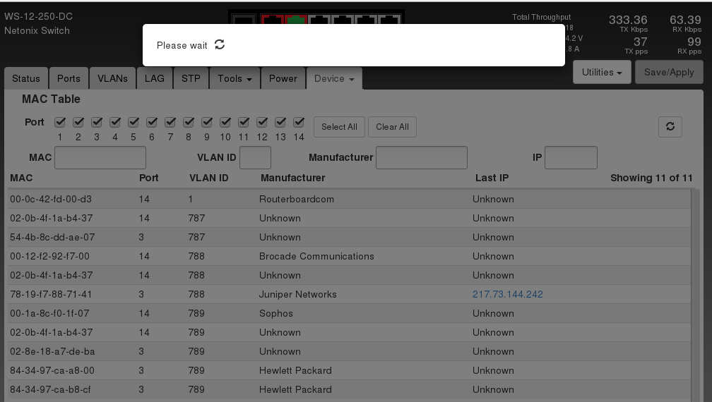

Access the MAC Table page works fine for the first time. But when I click the refreh icon or enter some VLAN ID as filter, the loading dialog appears for ever. I have to reload the complete page then. I'm using Firefox 44 here.

cegner wrote:Access the MAC Table page works fine for the first time. But when I click the refreh icon or enter some VLAN ID as filter, the loading dialog appears for ever. I have to reload the complete page then. I'm using Firefox 44 here.
Can you try Chrome and see if you have the same issues, maybe this is a BUG with FireFox????
I am not sure what you mean by loading dialog, please post a screen grab.
Also please post a screen grab of the Device/Status Tab
And you are sure this is v1.3.9 as there was a fix for MAC table display in v1.3.9

You're right, it seems to be a Firefox problem, Chrome works.
Firefox console shows the following error message:
- Code: Select all
TypeError: row.children[0].innerText is undefined
Yes, it's really 1.3.9 ;)

cegner wrote:You're right, it seems to be a Firefox problem, Chrome works.
This will be fixed in the next release.
