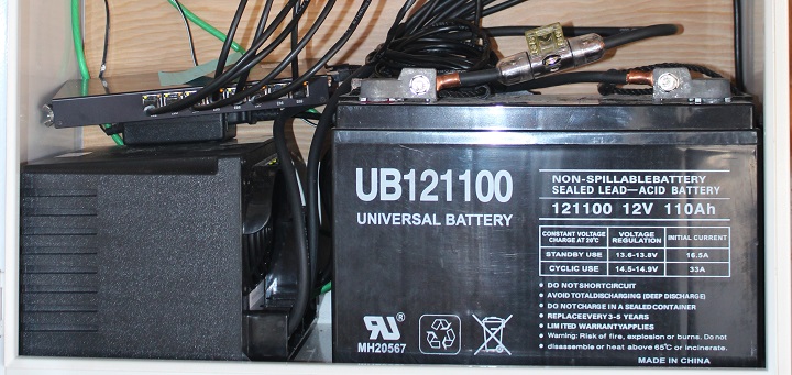

I don't have a photo of what we are currently doing, but here is a photo of what we were doing at our AC sites before we began switching to DC Netonix and MinnKota chargers.
Battery with MAXI fuse
Pictured is a Stinger SPD5601 in line fuse holder with an 80 amp maxi fuse to connect to the Tripp Lite APS750 inverter / charger. It is placed a few inches from the positive post on the battery.
https://www.amazon.com/gp/product/B001HXHKPC
Now that we feed directly from the battery into the Netonix switch, we are using a generic inline splice ATC fuse holder with a 30 amp fuse. It is placed in the same location as the SPD5601.
https://www.amazon.com/gp/product/B017BAF920
The MinnKota has its own ATC type in line fuses already build in.

I use a 30 amp fuse because I don't want to have to remember to change my fuse size every time I add or remove equipment.
Current DC model Netonix max is 250 watts
Min. voltage is 9 volts (in case of extended power outage and slow response to bring generator on site)
250 watts / 9 volts = approximately 28 amps
