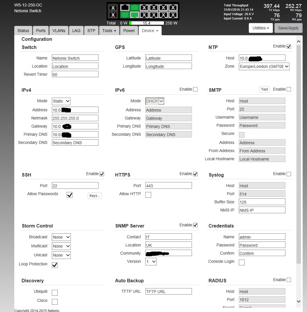

Here are the tabs
device status
As you can see its a simple setup. The switch uplink is from a CCR connected to port 4 which has a fibre backhaul connected.
The PBE-400 is connected to another tower. The CCR runs OSPF and prefers the fibre, but fails over to the PBE-400 is fibre fails.
Customers are connected to the rocket on port 3, PPPOE which is converted to EOIP and run over the OSPF network.
Let me know if you think any config needs changing the switch actually works fine apart from the crashing.
