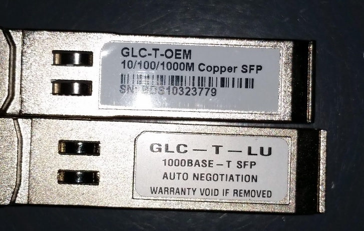

Re: Compatible SFP Modules
Fri Feb 12, 2016 11:10 am
pkats wrote:Do you have part numbers of ones you know work?
We have a bunch that we use.
We have not had any issues with just about any Cisco compatible copper 1G SFP modules we have purchased.
These 2 work fine but have many other cheap OEM units in service with no problems.
These are one of the few we found that work but work odly. Sometimes you need to pull them out and reseat insert them or re-boot the switch if there was a power blip or you tried changing the Speed/Duplex but they would work with either Auto or 1G if you reseated them or rebooted the switch after changing the speed/Duplex.
