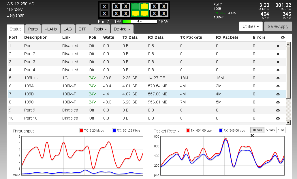

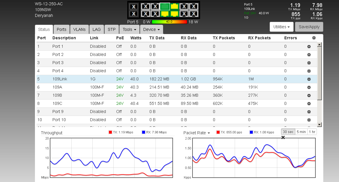

1.3.8 installed on 7 Switches with no issue except one switch which is showing incorrect power readings
the pic included shows the issue
- Posts: 7634
- Been thanked: 1361 times
Re: v1.3.8 FINAL bug reports and comments
Is it possible that the current sensors were off before the upgrade and you just did not notice them?
v1.3.8 sorta puts a spot light on them.
I would try a power cycle to see if they clear but if they do not this is indication of the current sensors being damaged.
If a reboot does not correct it I would collect that unit and bench test it as outlined in post #2 of this post
viewtopic.php?f=6&t=1259
Then if need be follow instructions on post #1 of that same thread above for RMA instructions.
If your current sensors are blown these are 2 good threads to read
viewtopic.php?f=30&t=188
viewtopic.php?f=30&t=1429

Buganah - Member
- Posts: 7
- Joined: Sun Oct 11, 2015 8:10 am
- Location: Libya
- Has thanked: 6 times
hi ,, thnx for the quick reply
how the current sensors would be off ?
i have rebooted the switch with the same condition , also noted that port 7 give normal readings than the others.
just as a note to you i have upgraded from 1.3.3 directly to 1.3.8 - but this also apply to all the other switches - and i have tried downgrading it back to 1.3.3 with no change
i will check the posts you referred and i will let you know how it goes
