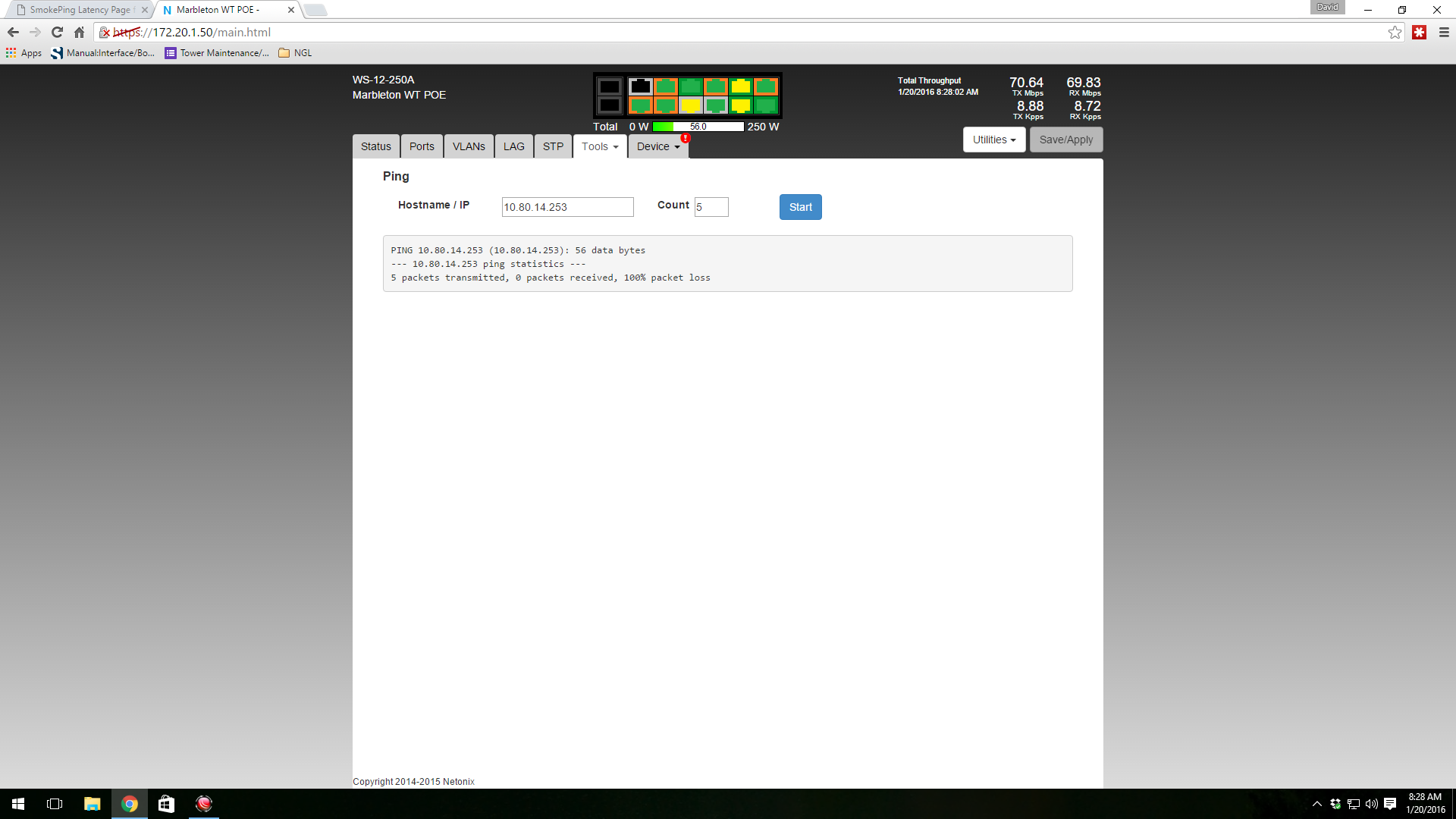

I wanted to report that we are still having problems with ping watchdog with ver 1.3.9rc13.
I woke up this morning and the stupid Ubnt Rocket Ti was down again.
I logged into the POE to verify that it could not ping the radio.
I then verified the watchdog setting.
I then bounced the port manually.
Then the POE can ping it again. The watchdog did not do its job.
Here is a little info on our setup. the POE is on its own subnet connected directly to the router. 172.20.1.50
When it is trying to get to the antenna it goes through the router and the router routes it to the core where it then takes an MPLS tunnel back to the site and to the radio. The router and the POE clearly did not have communication with the radio yet it would not trip the watchdog.
Been thanked: 1362 times
