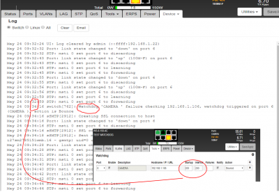

Hello
I think I found what I'm looking for
the problem is that I do not know how it works
for example I put 200 seconds for ping and reboot with an error of 1
I created a micro cut on my camera for 2 seconds but he still rebooted my device several times
I do not understand the seconds did not want my camera reboot but creates a watchdog why? :screwb:
