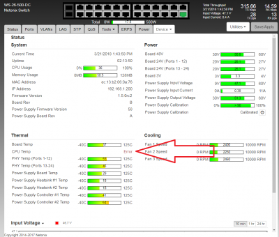

What happened next was pure luck but it was good luck so we will take it. We had people basically staring at the Device/Status TABs on several switches we were running tests on and we happened to notice that every so often we would get an intermittent ERROR on the Board and CPU Temp as shown in the picture below.

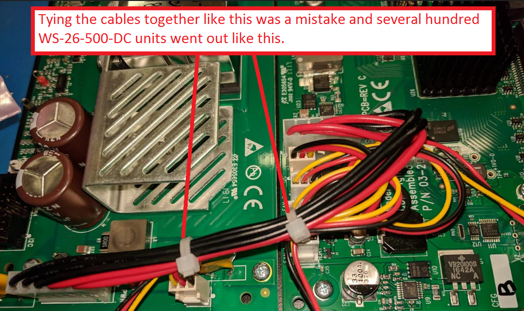

So we decided to open the chassis and check the I2C cable and that is when we noticed the cables were tied and this should not have been that way.

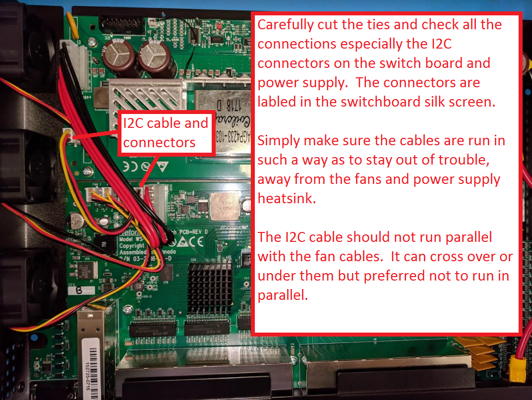

So we carefully clipped the ties off and did cable management as we had intended without these ties as shown below.
After making sure the connectors were all seated properly and the cables were ran properly we put the chassis back together and the intermittent I2C ERRORS went away.

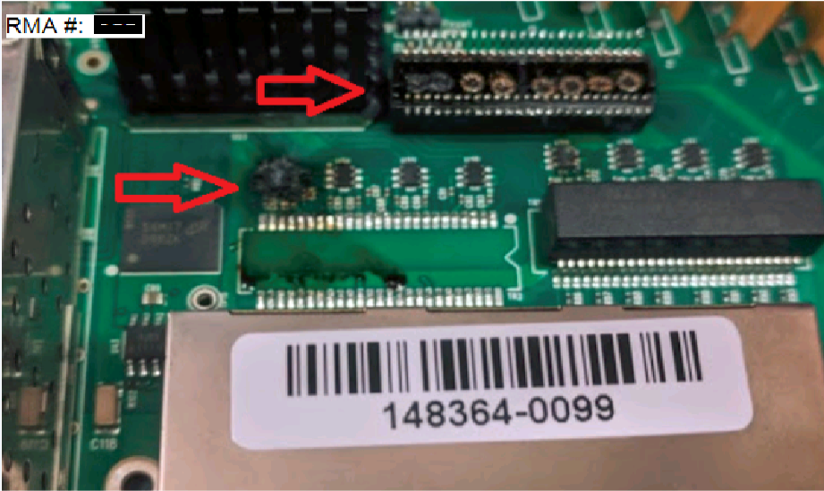

How many people send switches back with BLOWN/FRIED Ethernet Transformers claiming they simply died for no reason but we take them apart and see this (see below)
Ethernet Transformer will only get damaged in this manor from:
Shorted cable
Applying incorrect POE to a device or an incompatible device like "some" older Cambium radios.
Or "most common" from poor grounding specifically from not bonding Electrical service ground rods to tower ground rods and or electrical service ground rods are insufficient or degraded then when it rains they lose potential and the service see the tower ground rods as a better path to ground "through" the Ethernet Cable.
