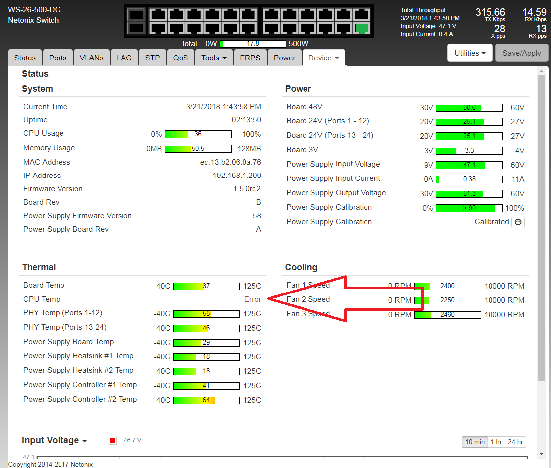

What happened next was pure luck but it was good luck so we will take it. We had people basically staring at the Device/Status TABs on several switches we were running tests on and we happened to notice that every so often we would get an intermittent ERROR on the Board and CPU Temp as shown in the picture below.

After making sure the connectors were all seated properly and the cables were ran properly we put the chassis back together and the intermittent I2C ERRORS went away.
But even with the ERRORS this should not have caused a watchdog reboot so our programmers and engineers went to work to find out why. Turns out a simple timeout was set too high which we reduced preventing the I2C service from getting backed up and starving the watchdog responder service from not getting enough CPU time to respond to the switch core to prevent a cold reboot. This software change was released in v1.5.0rc2
Now even if you have an intermittent I2C ERROR showing on the Device/Status TAB v1.5.0rc2 "should" prevent any reboots but I still advise you to check for the intermittent ERROR by simply sitting and watching the Device/Status TAB for up to 10 minutes after upgrading to v1.5.0rc2 and if you see this ERROR on the CPU or Board Temp I would schedule a time to fix it as described above in the picture. You are also welcome to open an RMA and send it to us to do but we are giving you permission to cut the warranty label if you see this error and it will not void your warranty on any switch with a manufactured date prior to this post as we have since corrected this and we went and opened every single switch in the warehouse and fixed any that were done wrong so this will not happen moving forward.
