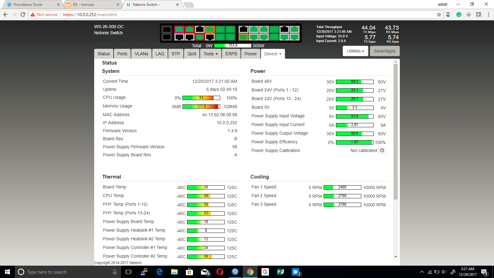

What would be the issue, why netonix is restarting itself, we cant find anything in LOGs. WS-26-500-DC
1. Memory usage is going full to 128Mb ( you can see in screenshot I took it when it went to 122Mb)
2. only 4 customers users are connected to the switch.

zubair wrote:What would be the issue, why netonix is restarting itself, we can't find anything in LOGs. WS-26-500-DC
Memory usage can be caused by multiple users logging into the UI or CLI at the same time.
Each user takes more memory and CPU.
Excessive SNMP polling causes high CPU usage, meaning do not poll the switch every second, once every 60 seconds is a good interval.
The switching functions have nothing to do with the CPU or memory usage. The switch core handles all switching/packet forwarding. The CPU is only a little MIPS 24K CPU used to run the UI/CLI/Stats/Daemon/Services like SNMP
READ THESE POSTS:
viewtopic.php?f=12&t=3349&p=22102&hilit=+cpu+#p22102
http://forum.netonix.com/viewtopic.php? ... nmp#p18877

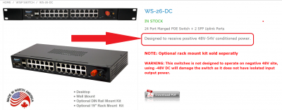

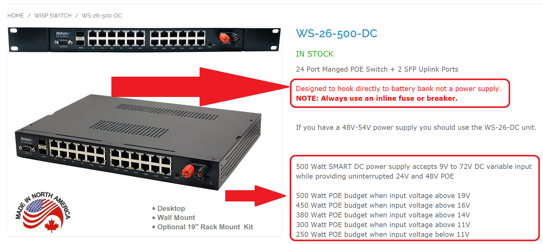

Our SMART DC switches are designed to hook DIRECTLY to the battery bank not a power supply. If your going to use a power supply you should buy the WS-12-DC or WS-26-DC which has no power supply.
Why would you spend the extra money for a SMART WS-26-500-DC when your going to power it with a power 48V-54V power supply? You should but they WS-12-DC or WS-26-DC which is designed for what your doing.
