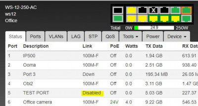

I'm trying to enable a port from the serial console CLI. :headb:
It made sense to me that there should be something under...
configure
interface port 5
...but invoking the ? help at that point doesn't reveal any command that looks like it would enable / disable a port.
Worst case is there a way using touch or something under the Linux command shell?
I've tried searching the forum with no luck so I've had to resort to asking. :???:

Disable
Code: Select all
ws12# configure
ws12(config)# interface port 5
ws12(port 5)# shutdown
ws12(port 5)# exit
ws12(config)# exit
% Applying configuration...
Press ENTER to confirm configuration change. If you do not hit enter within 60 seconds the switch will revert to the previous configuration.
port disabled in CLI
Enable
Code: Select all
ws12# configure
ws12(port 5)# no shutdown
ws12(port 5)# exit
ws12(config)# exit

Thanks to jakematic now I get it Image
I did use the online help and IIRC, I did actually try 'shutdown' and 'no shutdown' but didn't realize that it wouldn't take immediate effect so it didn't seem to do anything.
