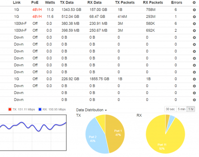

Curious how the data stats are being reported. Note the pie chart shows nice load balancing ... but data report is not balanced. The top two lines are the AF5X with LACP-A.

Re: Guidance on AF5X NxN LAG Setup
Edgar,
1) you have to disable in-band management (use management port), 2) you have to create the LACP-A on both ends at the same time, 3) we used Key = 1, left priority at default, but both links must have equal priority, 4) source/destination IP enabled. I meant to turn on RSTP but forgot and seem to be OK.
