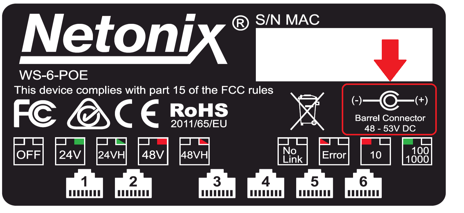

agidi wrote:yes and how many watts of APs can i load on them.
You can not power the WS-6-MINI with 24V
I am confused why you thought you could power the WS-6-MINI with 24V ?
The switch "might" power up with 24V but it will not provide any POE.

Re: 2 WS-6-MINI on 24vdc via barrel?
thought i answered that with the 100w thing, guess that got kind of lost in excess information.
powered via barrel adapter: switch can draw 100w safely. 48v 2.25A supply will be sufficient. you will have a ~92w power budget for powered devices. Drawing in excess of that budget will have an adverse effect on system stability, but should not damage anything irreparably, caveat emptor.
is hopefully succinct.
