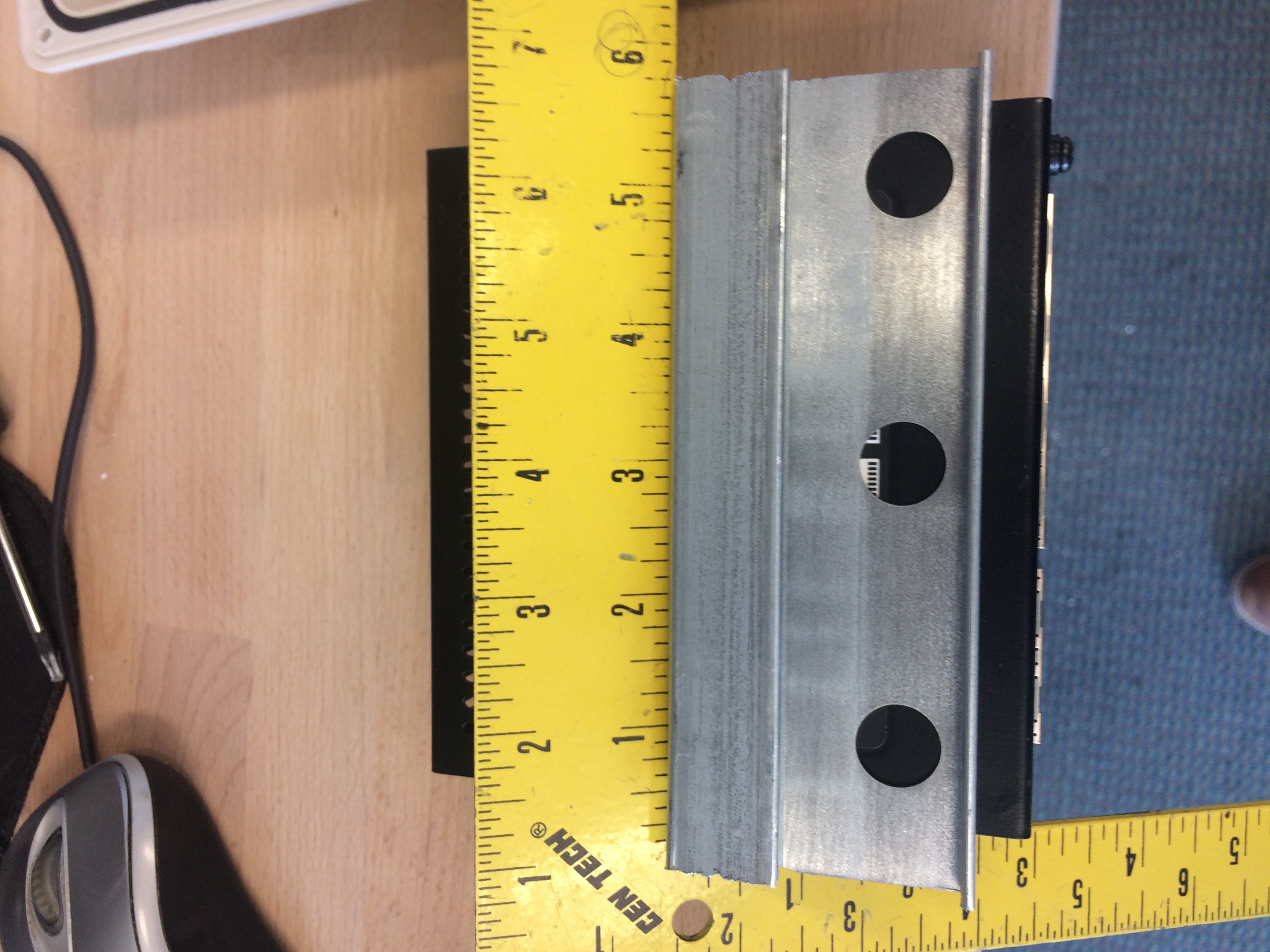

Not sure how it is supposed to work, short of screwing into the enclosure, but a piece of Ikea counter mounting rail fits perfectly between the strength webs in the enclosure.

Plastic isn't the best heat sink, and unless you cut the webs, the switch hits the webs before it sits on the back of the enclosure so there is an air gap. I figure a big chunk of steel makes a good heatsink. It would be interesting to set up two, one mounted the way Chris describes, and one mounted using Ikea rail, put them under the same load, and then graph temperature.
Just figured I'd post it in case other people happen t be looking for mounting options. I just happened to have spare ikea rail in my lab because I built out my lab using Ikea counters.

with the current generation of switches dave redesigned the 3.3v downconversion circuit to obviate the need to use the chassis as a heat sink, so I'm pretty sure you'd get very close results if you did that test.
Cool use for ikea rail, though, i like it! :)

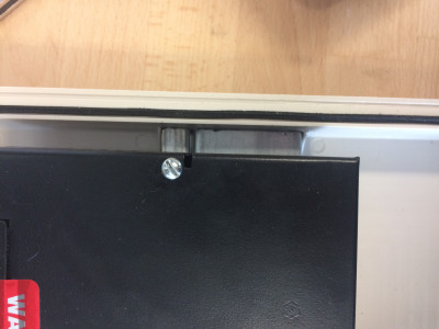

petecarlson wrote:Plastic isn't the best heat sink, and unless you cut the webs, the switch hits the webs before it sits on the back of the enclosure so there is an air gap...
Unless something changed, my MINI has air slots into which the webs fit so there was no air gap. I raised the same point with Chris about plastic not being the best conductor. It is still better than air...
Also, I cut the webs because I like the switch to sit lower down leaving more space at the top in case I want to access the reset button.
Re: Mounting WS6-Mini in ENC-SW-8X5
Yea, the "production" WS-6-MINI has slots for the webs so it sits flat against back wall. You got a pre-production model Les
