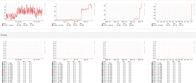

LibreNMS was just updated to include DC power input and Total Power usage. We also get detailed STP information now that WispSwitch supports BRIDGE-MIB. I hope they add LLDP-MIB next :)

It would be lovely if there was a OID for total power consumption
Then I could have a calculated item in zabbix for estimated battery time remaining .. :)
Eric Stern
Posts: 532
Location: Toronto, Ontario
Been thanked: 130 times
Re: LibreNMS Netonix Support Updated
Tue Sep 27, 2016 6:47 pm
Its already there. 1.3.6.1.4.1.46242.6

Ok so I'm just learning how to do this but when I add a netonix device to libre I don't get any of the above? does Libre not poll the device ?

shaunm wrote:Ok so I'm just learning how to do this but when I add a netonix device to libre I don't get any of the above? does Libre not poll the device ?
It automatically adds all of that, perhaps your install was not up to date?

It is as described in the ticket. Netonix does not fully support Q-BRIDGE-MIB, they only implemented some of the required fields and some incorrectly.
They seem to have a habit of only partially implementing standard MIBs. They are aware of the issue and hopefully get it it fixed next release.

Overall consumption is useful but is it possible for LibreNMS to obtain individual wattage / consumption per POE port? With solar sites it'd be really good to have stats on what a radio uses over a 24 hour period etc.
