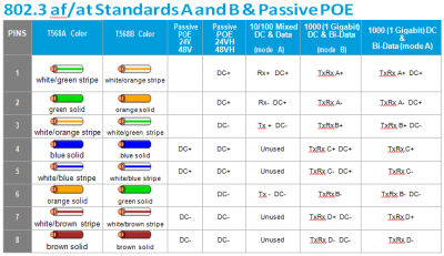

Answer: Our switches are "passive" POE which means if POE is enabled on a port the power is live so if you plug in a cable that is shorted or the piece of equipment is bad or has an incompatible polarity PIN OUT you will damage the port in the switch and probably the equipment, this damage is not covered under warranty.
There are 4 Pairs and 8 PINs in an Ethernet Cable:
Pair 1: White Orange.(PIN 1 ) & Orange.(PIN 2) is POSITIVE
Pair 2: White Green...(PIN 3) & Green...(PIN 6) is NEGATIVE
Pair 3: White Blue.....(PIN 4) & Blue.....(PIN 5) is POSITIVE
Pair 4: White Brown..(PIN 7) & Brown...(PIN 8) is NEGATIVE
24V POE Option @ .75A - constant draw can surge/spike to 1A:
802.3af/at MODE B [i]pinout[/i]
Pair 3 / PINs 4, 5 are POSITIVE
Pair 2 & 4 / PINs 3, 6, 7, 8 are NEGATIVE
48V POE Option @.75A - constant draw can surge/spike to 1A:
You would use this option to power most 802.3af/at devices like IP Phones and Cameras
24VH POE Option @1.5A - constant draw can surge/spike to 2A:
802.3af/at MODE A & MODE B [i]pinout combined[/i]
Pair 1 & 3 / PINs 1, 2, 4, 5 are POSITIVE
48VH POE Option @1.5A - constant draw can surge/spike to 2A:
So now that you know what the PIN OUT is (which is in our Spec Sheet on page 17 and in the product description on our web store) all you need to do is look at the spec sheet from your device and see which POE option you can use.
If they do not specify the PIN OUT polarity break out a multi-meter and but one end off of a patch cable and strip the wires and figure it out on your own.
Also if they have a bridge rectifier circuit like MIMOSA the device will swap the polarity the way it wants it.
WARNING - If your equipment is not specifically designed to accept power on all 4 Pairs do NOT use a VH POE option.

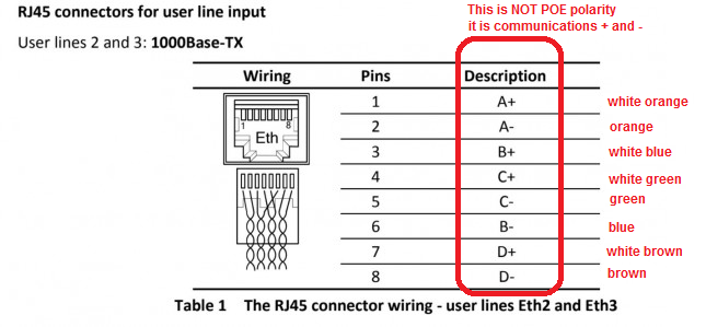

Im struggling with this POE++ concept it seems like there are so many different versions of this ? I have an Alcoma MP400 link and NEC Pasolink pinout as below even though its claimed at POE++ the polarities are not the same. Do you think 48VH can work here?
NEC Pasolink same pinout also claims POE++

Your picture has nothing to do with POE polarity it is discussing communications + and -
Therefore you need to follow the instructions laid out here in this post: viewtopic.php?f=6&t=1178#p8809
So if you own a Volt Ohm Meter simple use it to map what polarity the provided POE supply is providing on what PINS.
From what I can tell the radio says it uses 802.3af/at with a MAX of 35 watts so 48V should be OK??????
You need to map out the provided POE adapter to be sure.
