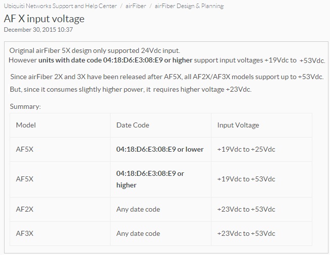

airFIBER 2X, airFIBER 3X, and airFIBER 5X work with 24V standard up to about 160 feet of cable and 24VH for runs up to 326 feet of cable.
DO NOT USE 24VH ON ANY AIRMAX RADIOS OR YOU WILL FRY THE RADIO AND THE PORT.
NOTE: According to UBNT new models of AFX radios will also support 48V and 48VH, see UBNT forum for more info or search this forum for other users post on their findings.
cbl wrote: Here's the URL on UBNT's wiki that details which MACs do/dont support the 48V power on 5X. Note that 2X and 3X all support it.
https://help.ubnt.com/hc/en-us/articles ... ut-voltage

airFIBER X radios use 24VH - THey are the only radios that use 24VH. THey will also work on 24V less than 200' of cable.
AFX
