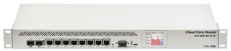

Mikrotik CCR1009-8g-1S-1S+ : 48V only - 24V WILL BREAK THINGS

Mikrotik CCR1009-8G-1S-1S+ is running great on 48V
It supports 14v to 57v input on the poe port however it draws as much as 35 watts which is way too much for 24V (1.5amps)
Running at 48v puts us back at .75amps which is good to go for the Netonix ports ;)
