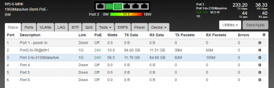

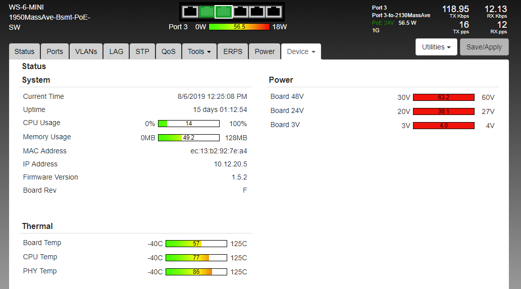

We have a WS-6-Mini that's powered over a 3 ft cable by a Ubiquiti AF24 PoE injector, i.e. 50v and up to 1.2A. It in turn powers a Ubiquiti PBE-5AC radio and a MikroTik RB2011 router. The site was installed 21 months ago and has operated w/o problems until a week ago when we got over-voltage alarms from the mini-switch. The site is still on-line and behaving normally except for the over-voltage indication and an unusually high wattage reported on port 3. I suspect the excess wattage on port 3 is due to fried current sensors. I don't know whether to believe the over-voltage readings or not. If true, at 30.1v the 24v supply is way over-voltage.
The MT router specs say it's good to 30v. But I'm under the impression that >28v would fry a Ubiquiti radio. Unfortunately, ubnt doesn't provide useful specs so I'm relying on on-line discussions.
Since the site is still working in all other regards, it may be a few more days before someone goes to investigate. Is it possible the voltages are ok and only the measurements have failed?

Your unit is damaged, most commonly caused by ground current which fries a current or voltage sensor. However since all sensors share the same bus if one gets damaged in the right way it affects others.
When you swap it out of service you can open it up and examine the board (both sides) and the damage should be visible.
Keep in mind GROUND CURRENT is AC voltage normally 110V but often the frequency is much higher than 50/60Hz which allows the current to pass through filter CAPs designed to squelch noise on the line. This AC current does not have to be high amperage to cause a lot of damage. Lab tests show current sensors blown off the board with as little as .1 milliamp. Keep in mind your talking about 120V AC flowing through the board > 50/60M Hz sometimes as high as 500 Hz or higher from harmonics caused by failing electric motors compressors or the current comes in from the service provider as the electric company hands off (2) hot, 1 neutral, and 1 ground and all grounds in an area are bonded together.
Now if your electrical service rods are insufficient to absorb the current and the tower rods are seen as better path to ground the current traverses the switch/cable to get to tower grounding system. Bonding all ground services helps but not 100%. Anytime you lose equipment from suspected ground current add 2 more service ground rods. I have a tower on a mountain top with rocky soil providing poor ground, took 6 additional ground rods before problem stopped.
Ground current damage often occurs during rain events as the rain envelopes the ground rods reducing their capacity or increasing their resistance to ground.

If you have a unit that is not working right RMA the unit. We will provide a full report of what we find. If it failed we will repair it free and return, if it is damaged we provide a full report with pictures of damage and our best guess as to the cause and there is a fee for the repair.
Step 1 is to RMA the unit.
Even if a unit is out of warranty period we will still repair it for a fee which is cheaper most times than buying anew unit.
