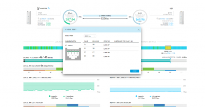

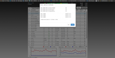

Here is a screen grab of the equipment while power on we will need a tech to go on site to see what the cable test shows when powered down.

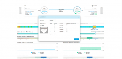

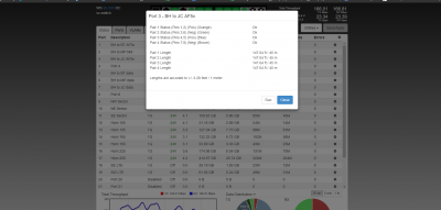

Show me screen grabs of the other side
Re: AF5XHD short on WS-26-500-DC
Here are pictures of the other end of the link.
I still think it is the radio, cabling, or ends as each port in switch is different Transformer, different PHY, different everything and you switched ports in switch and got same result.
