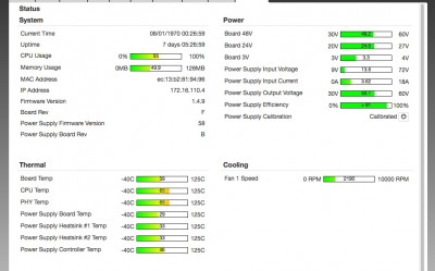

Can you please post up the a screen grab of the Device/Status TAB of the units that causing you issues.
See my post signature for instructions on uploading screen grabs/attachments.

Attached :thumbsup:

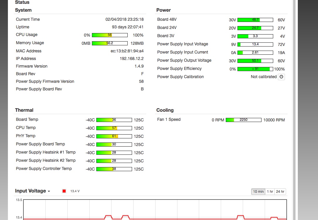

Here is another switch we took out of production (the initial time it happened).

So the input voltage is around 13-14 volts.
Please describe how the switch is powered.
How much is the total watts being used.
Unselect all ports and show the main Status TAB which will show what each port is delivering and at the top the total watts being used including the switch plus POE.
